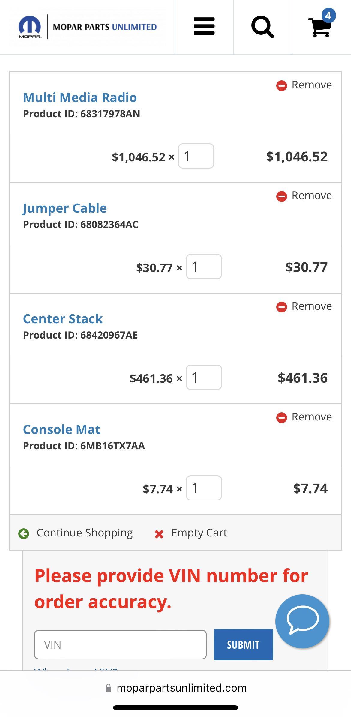

I have a 2020 Ram 1500 Bighorn 8.4” without navigation. Wanting to upgrade to 12.1” and have nav and single zone climate control.
Is there an additional “temp sensor” of sort that I would need, besides the following (see pic)
Also, most of these part #’s say “doesn’t fit” my truck…
I know I’ll also need the pin adapter from @Jimmy07 and the OBD stuff…
