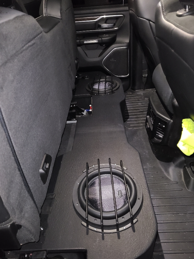

Finally completed making my sub box, got the new pair of 10s installed. I just swapped them in exchange for the single 12" L7T.
