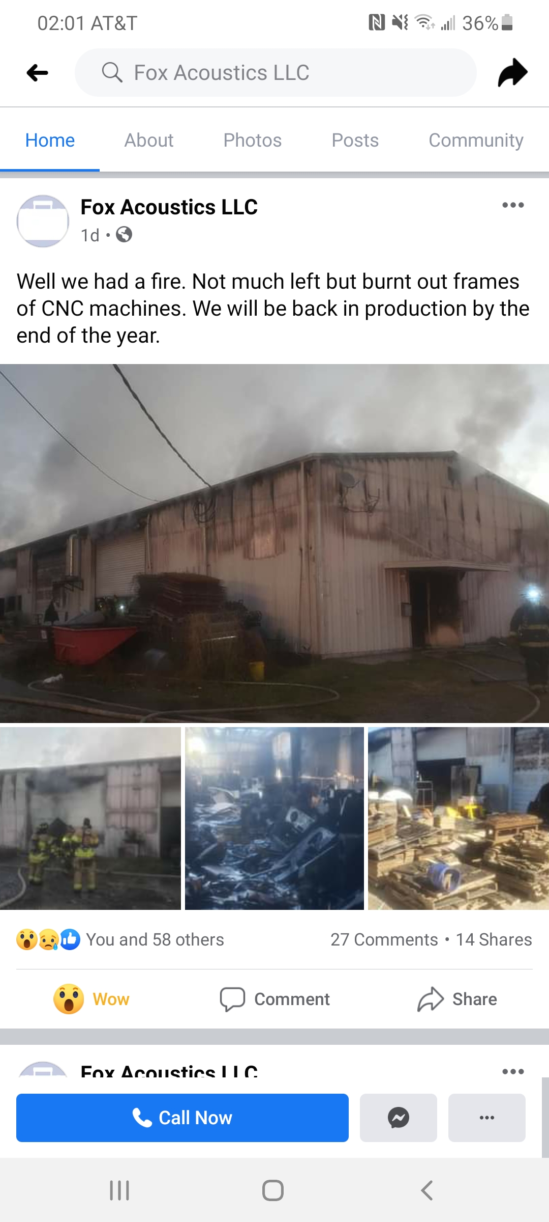

I just hit the 1 month mark. I expect get shipping information this week or the next. I guess I’ll find out how it goes. Hopefully I won’t have to file a PP claim.
They posted this Tuesday!
That's sad, i've heard good things about their work i was a little upset for waiting so long for such an expensive sub box but i guess is because i can build my own i don't think it's such an hard task, once you have all the panels built all you have to do is copy them to build more.
