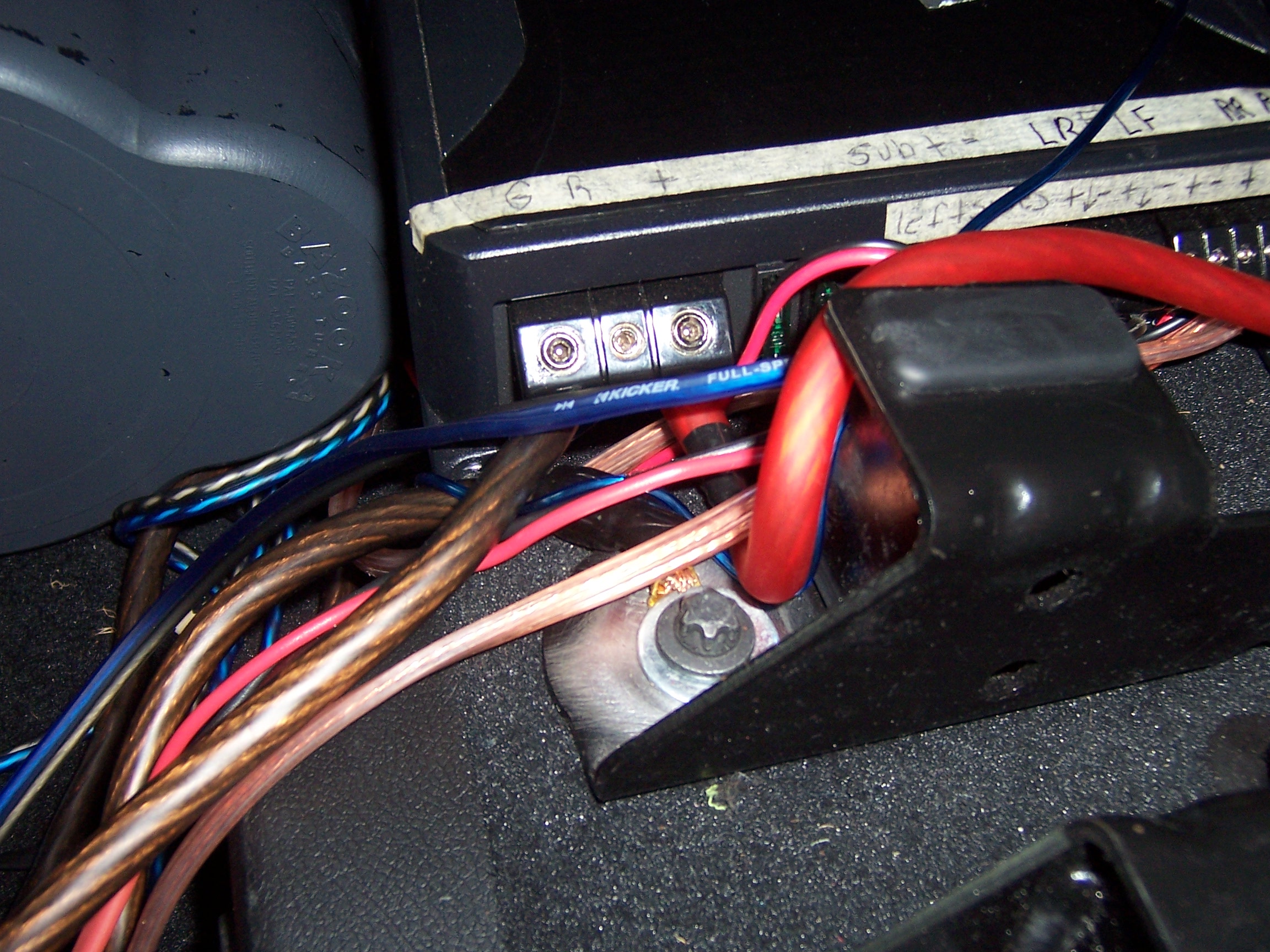

I just had the Kicker Hideaway 10 installed at a reputable shop and they can't seem to get it to work. He blames it on the box. They tapped into the high side somewhere thinking he bypassed the ANC.. It's not the Kicker. They sent me a replacment and it does the same as the first 1. Barely anything comes out of it unless all dials are cranked to the fullest. I'm wondering if I get that bypass harness that i've seen people on here talk about, if that would make it work right.
First thing that comes to mind... on a dual voice sub, if one voice is out of phase with the other, you'll get almost no output (i.e. switch the +/- high-level inputs on one channel only to test that theory). But I would think they've tried that.
Yeah...reversing the polarity on my sub made it work.
Also...did they bypass the ANC (not just go before)

Here are pics of where I had them mount the Kicker Hideaway 10. It's not a box just made for our trucks, just 1 that I liked that would fit and not take up the whole back seat. I ordered an ANC bypass harness (iDatalink bCH3) from Crutchfield. I will let you know if it fixes the issue.

I’ve been doing car audio for a very long time, PLEASE re-do that ground today! I know you’ll hate to hear this, seat post are the absolute worst to ground to. Drill a hole, scrape the paint away!!!!! Star washer if you need to, and silicone. (Prevents water) I used to uses GM battery posts as my ground, and attach to that.
Bottom line 95% of all audio issues, THE GROUND WIRE!!!
I have not read your post, don’t know your problem, but.... Start with that. I can’t stress this enough.
If your close, I’m happy to help.
Thanks. I will fix the ground this weekend. Thats the way the guy at the audio shop did it. I actually only plugged it in for the pics. Since it doesn't want to seem to work without the bypass harness I have kept it unplugged until the harness comes in.
I would take it back and say what the **** did I pay for. MECP will fail your *** for this! Heck Best Buy should know better too. Sorry for the lack luster install. Should be easy to get high level and get it working. My guess again, install.

this is simple and gets the job done.its how we use to do it "Back in the day".used a wire wheel on my dremel.clean off the paint on the bracket frame on the rear seats and bolt it down.not saying it will work for you,but its the bet ground i found(old school)
No using anything but the solid gram of the vehicle. You CAN NOT use any metal that’s attached to the frame! This creates a ground loop! So, bare metal, to the dead solid frame! Yes, scrape away the paint. Again, if you want to do it right. If folks take short cuts then the sound may suffer.

How about a factory ground location? Although there have been reports of those being suspect, as in being painted before assembly and lack of paint cutting washers
