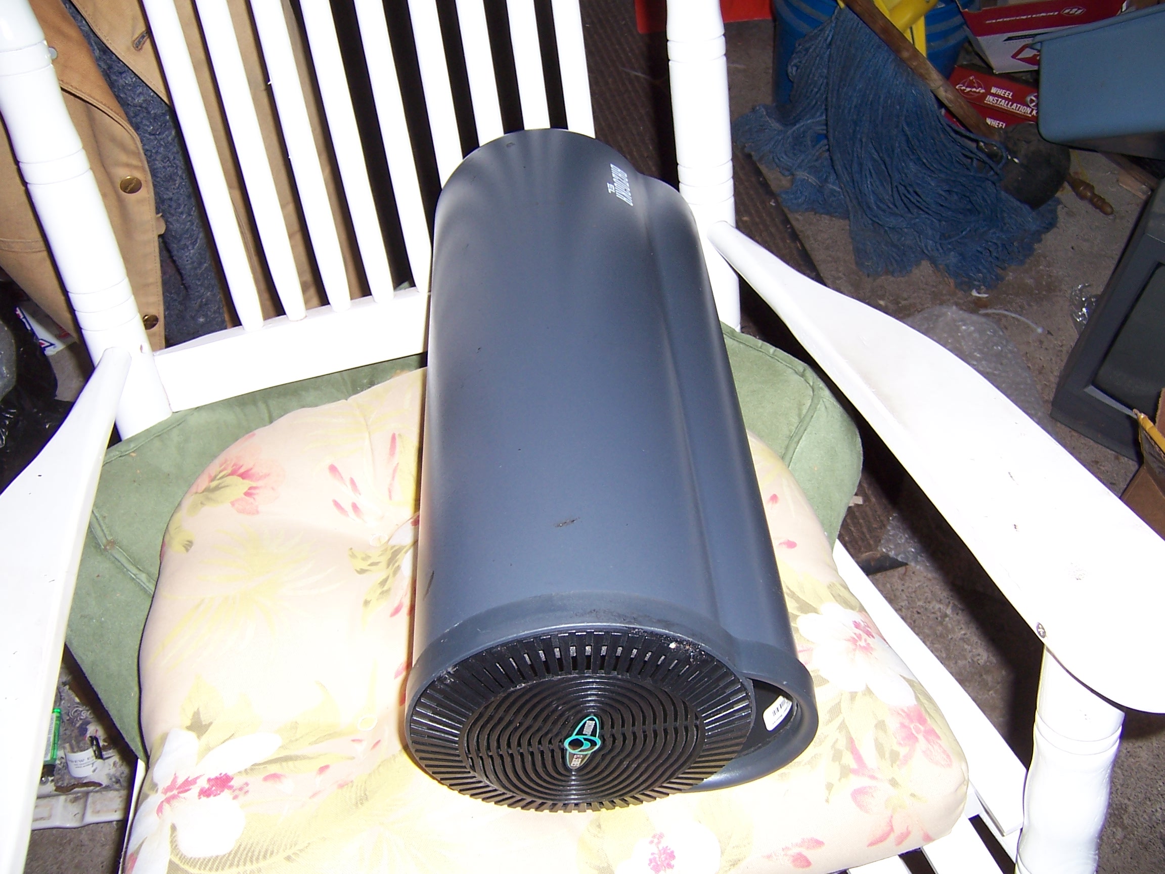

in the beginning i used the "StockAmp".but since i had some "Amps" laying around in my garage.i used them.and the sound was increase so much.hard to describe.the songs you like are going to sound so much better.".Unbelievable " (y) .i played this song with the stock amp.thought it was good but when i installed the new "Amp" o_O .i left the stock woofer in place.i have a 5ch amp so i just added and old "bassTube".

i had this old "Thing"left in my garage.the speaker was "Blown".just went out and bought another.i run it off my 5ch amp.i did not "Tap,cut or splice"in the stock one.no headache of all that cutting and such,no need to.i left it in tack along with the new one.how does it sound...?........ :love: :love: (y) !(IMHO!)
