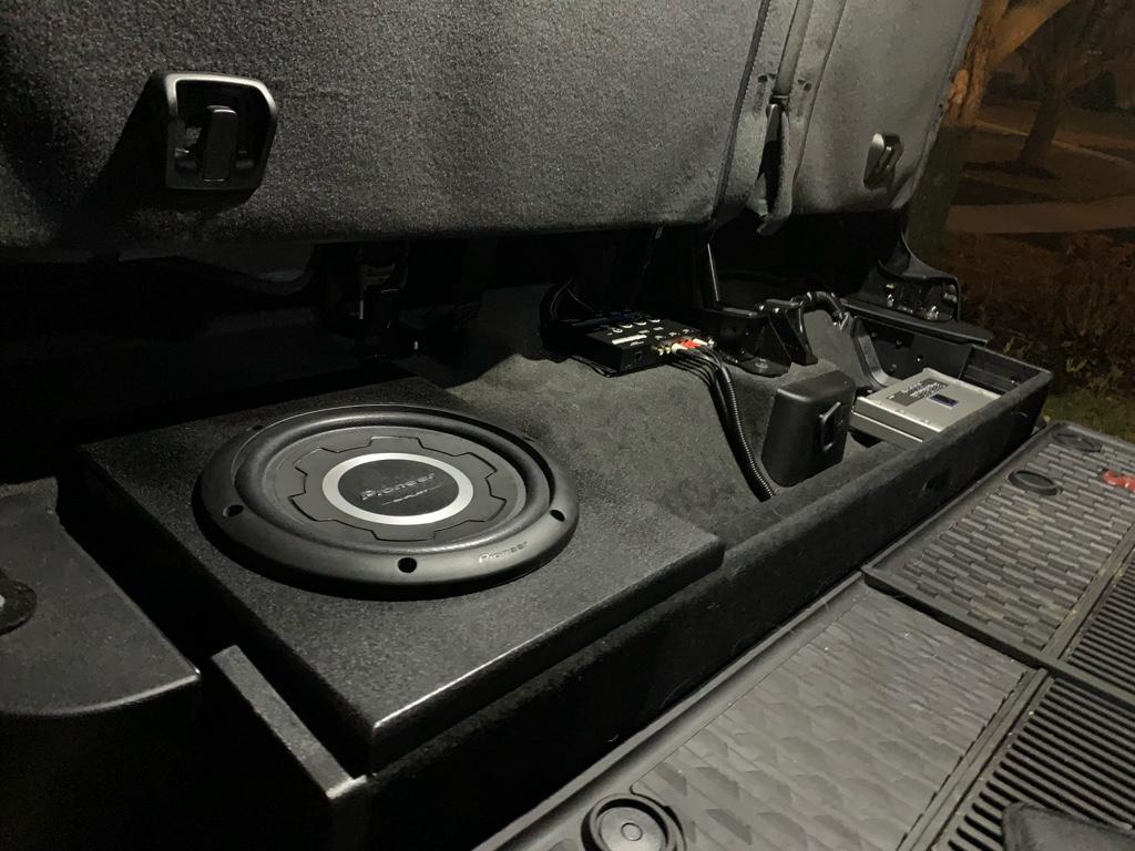

Going to let it sit overnight then into my truck it goes!
Looks great!

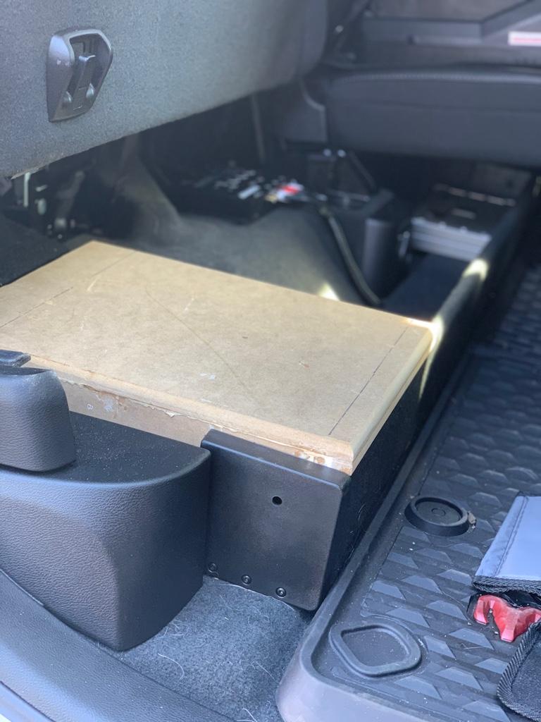

Looks great. What would you estimate the volume to be in there, say if your box was extended to where the rear seat splits?
I might do the rear seat mod, raise it 3/4" so that I can fold them down to mount my amps. So that will gain me some height for my box build as well.
My volume is 0.35-ish which I think is the bare minimum for my sub but no biggy. You could probably increase that by at least 75% but your cuts will get very interesting. There’s a reason i stopped mine at 13” wide. Beyond that the floor has a lot of weird nooks.
Hooked up everything tonight and it hits well. Need to fine tune my cut offs but finally done tinkering with my stereo...for now.
I’ve got everything for mine, except my box. Fox Acoustics says 3-5 business days but I ordered it last Friday and still nothing. Not a huge deal but anxious to get it going lol.
Looks very clean ! Nice work !! (y)
Just a heads up mine took a few weeks to arrive (2-10's ported). I called after 1 week and they said that they were behind and moving shops. I did finally get it and it looks great have not installed yet though.
