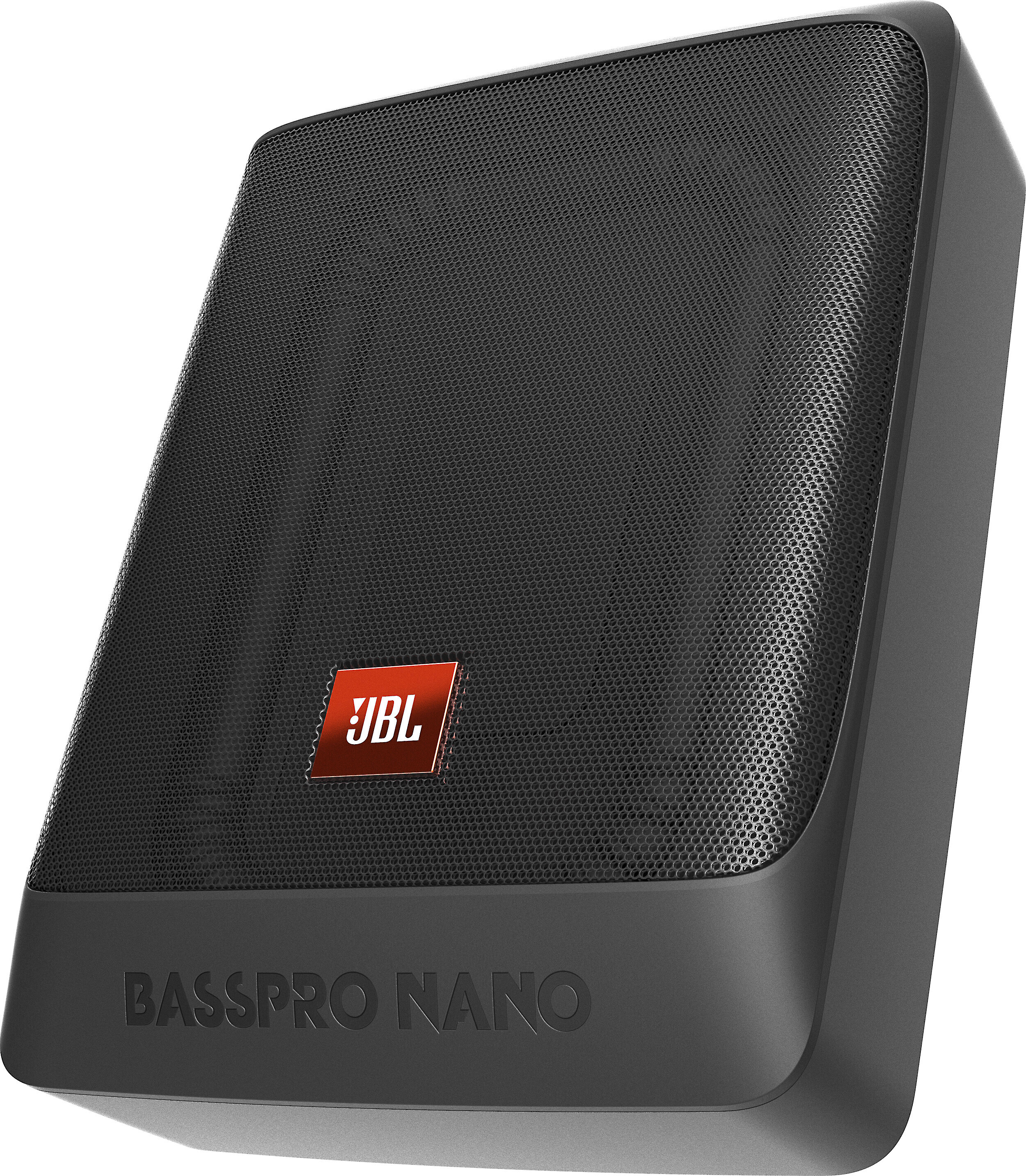

Has anyone been able to fit a slimline sub behind the back seat?
I was considering going with something like the Slimline behind the seat, but there is what maybe 3" of space.
I want to use a full size sub, so I may go with this, nothing much to offer for the quad cabs ugh.
Yeah space is limited enough in the quad cab so underseat subs probably arent gonna work for me. Unless its just a slimline sitting on the floor. Looking more to stuff a slimline under the passenger seat or on the back wall or something.
There is a fair amount of room on the back wall. Remove the "fake wall" and you could make something happen back there.
