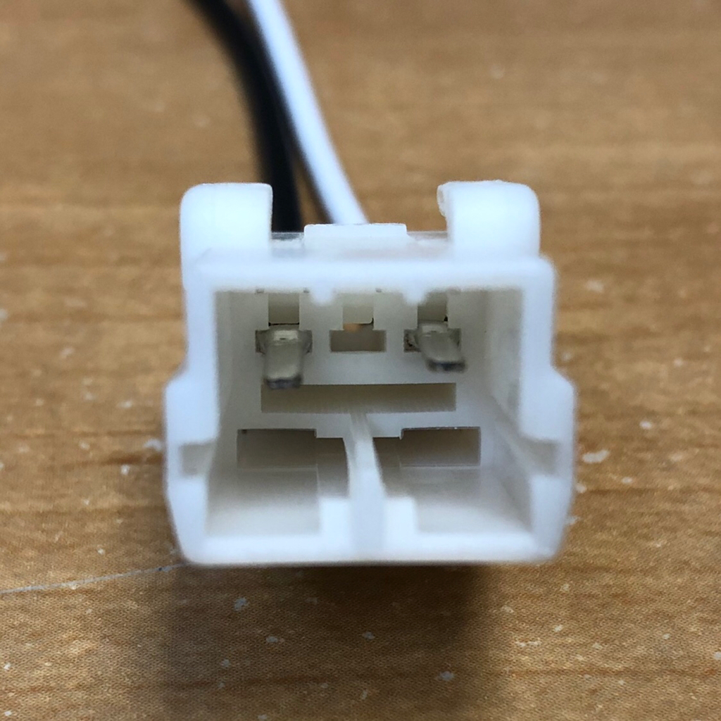

Does this look like the wiring harness for the dash speakers?
No, it looks like the connector for the door speakers. Be aware of polarity issues if this is an adapter. Some swapping of connector pins may be required. See previous posts on Metra connectors.
