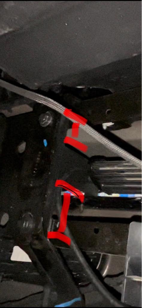

This is a closer look how I mounted it. I took a quick vid.

I will be doing this mod myself very soon, And like you I have the active air damn as well. I will be milling 1/2" aluminum spacers to go between the top bracket bolt hole and the bumper frame to give the angle necessary to center the light bar in the grill using the inverted bracket method others have used if that makes any sense
watch my video. You won’t be able to do that if you mount them where I did. You could drill new holes and mount them Inward

If the brackets get swapped sides and our portion of the bracket is mounted inboard of the bar it catches some factory holes from other installs i've seen. I do like how you did it though. I linked your video and waterfowlers video in the description on the page now.
Yep it can, but the holes are just too small so they have to be drilled out. That was my first plan.

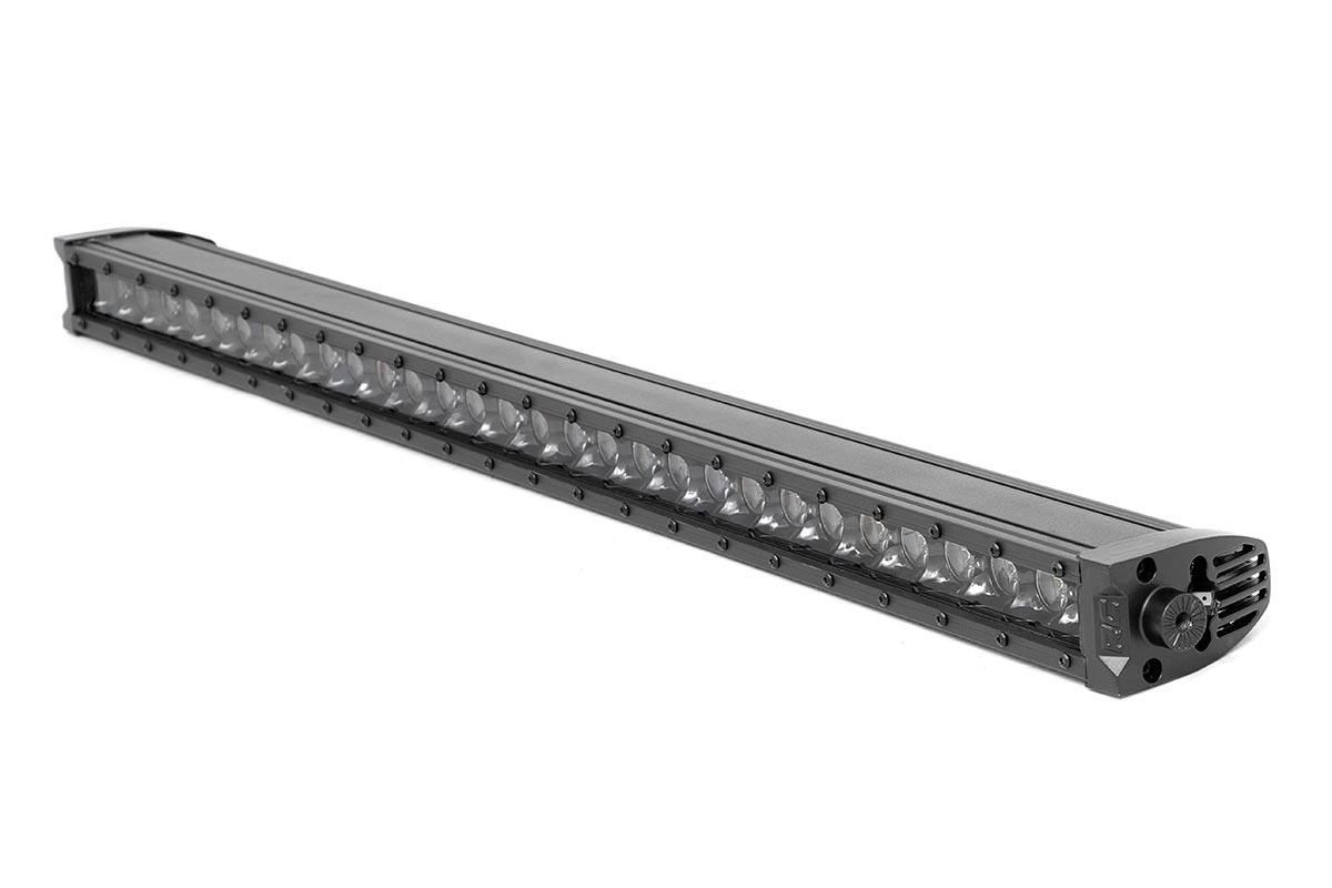

I was planning on buying the Rough Country 30" lightbar. To make it an easy install and still having a quality led bar instead of a 50 dollar Aliexpress brand.
This one has no DRL function and is Length: 31.37-inches
or this one, with DRL function and is Length: 32.1875-inches
Will they both fit?

There is adjustments that can be made in the brackets. I believe both bars would work just fine but I haven’t tested them. People run lots of different bars with these brackets but we’ve only tested the Diode Dynamics bar. The newest version of our brackets fits underneath the extra support bracket and a few people have installed under that bracket. I’ll link a video to show you what I mean.
