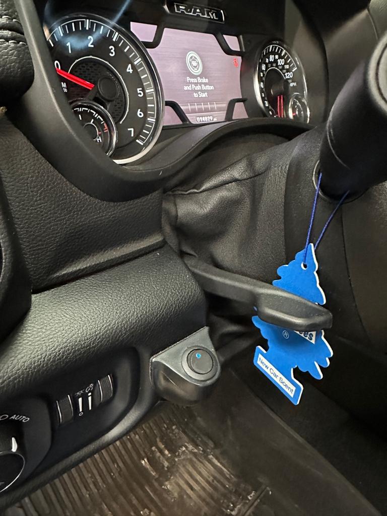

For those that aren’t using some sort of controller, where did you decide on mounting the switch? I just decided to go through the blank trailer brake controller. Didn’t need to take the radio out, just drill the hole, stick a fish tape through and reach up in and grab it to pull back through View attachment 175577View attachment 175578
Here. Didn’t require drilling and easy to turn on and off
