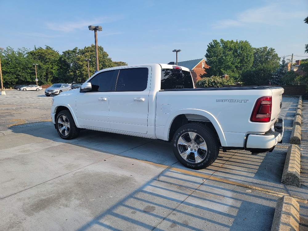

These are LT285/60/20. Little bit of a stiffer ride for sure, but road noise is pretty minimal. No rubbing, 2.5" lift

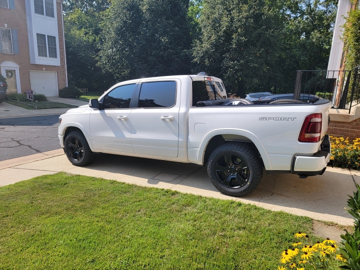

Went Lt 275x60r20 Falken wildpeaks At3w on Ram black wheels. These are D rated 8 ply and measure a bit wider then the 4ply P rated.
P rated is 33x10.8 vs D 33x11 per falkens website
Before and after pics included

My wheels are +1 offset too! Fuel Contra 20x9 +1....and I think I am still getting a little rubbing depending on the angle of the turn and elevation.
Have you got any side on pics to see the +1 offset?
