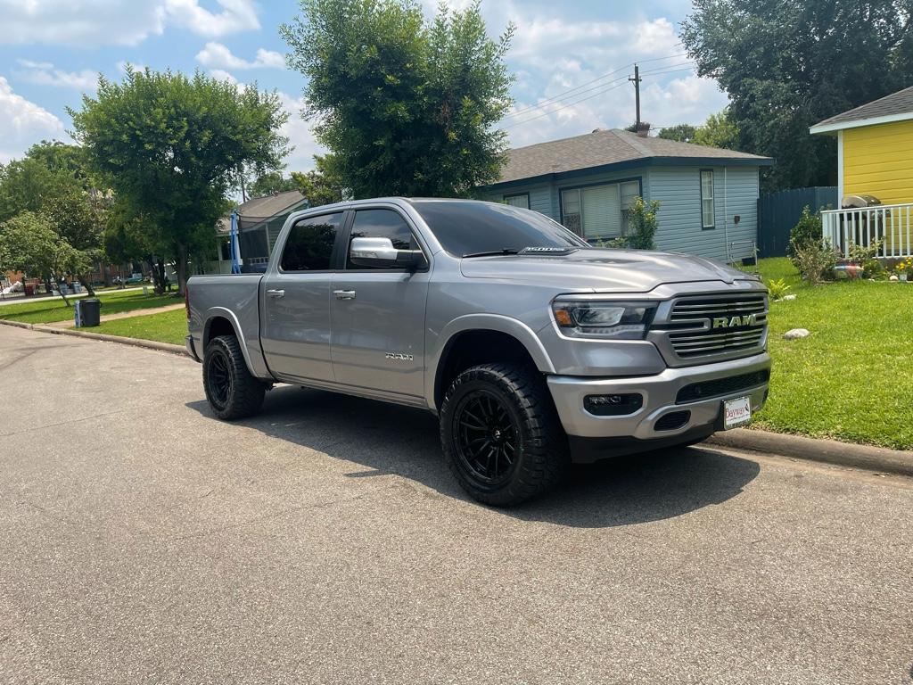

@Morenar here's a few pictures. Sorry for the delay. It's been horrible weather. View attachment 99378View attachment 99379View attachment 99380View attachment 99381
Here's the 285s. WView attachment 99382

No spacers. Small amount of rubbing, I have not fixed it yet but its not bad. Road noise is there, slightly more than a BFG all terrain. Put it this way... my wife never complained and does not think it's noisy.

I have the same 22" stock wheels -When I went to get my 285/55r22's put on at the tire shop, the tire was hitting against the UCA when the truck was jacked up and suspension at full droop. They refused to mount the tires and put my old tires back on. I had to go to another shop that was okay dealing with spacers. I have the Rough Country forged UCA's, which may stick out further on the top of the ball joint causing my issue.
Wanted to add in my experience as it seemed relevant.

No clearance is for me with the arms. I don't offroad my truck at all. I do have rubbing but it's wheel well on occasion. I do plan to fix, just need some free time.
Does the tire stick out the side of the truck at all or is it flush? Did you level or add any height in the back?
It’s hard to tell in the picture but it sticks out about 3/4 of an inch, just enough in my opinion. If the tires were 12.50 wide they would stick out a little more but these are about 10.5 wide. Also stock Suspension in the rear .2F686D46-F275-4D7A-93BE-7FA193003106.jpeg

It’s hard to tell in the picture but it sticks out about 3/4 of an inch, just enough in my opinion. If the tires were 12.50 wide they would stick out a little more but these are about 10.5 wide. Also stock Suspension in the rear .View attachment 99724
