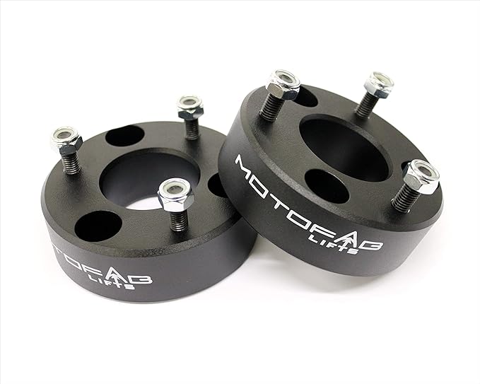

  • Just picked up this leveling kit 2.5" MotoFab. Waiting for it to show up from Amazon. I watched the installation video on Utube, doesnt look too intense of a job. Cant wait to lift the front of the truck up to where its supposed to be and stop bottoming out the splash guard every time I hit rough road!
  • MotoFab Lifts DR-2.5-2.5 in Front Leveling Lift Kit Compatible with Dodge Ram 1500 Pickup 4WD
Roll over image to zoom in
by MotoFab Lifts
4.4 out of 5 stars 76 customer reviews
| 63 answered questions
Amazon'sChoicefor "leveling kit for dodge ram 1500"
  • Will Raise the front of your truck by a true 2.5"
  • Motofab Lifts are CNC machined out of billet aluminum then powdercoated black to match your factory suspension.
  • Can be installed in about 1 1/2-2 hours and does not require strut/coil disassembly like other kits.
  • Made In The USA with a Lifetime warranty
  • Compatible with Dodge RAM 1500 4WD 2006-2018 (DOES NOT FIT 2WD)
See more product details
