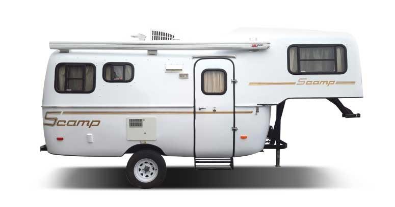

Hey guys, there are lightweight 5'ers. There are 150/1500's that can pull them, especially Ferd's with their max-tow package. RAM, not so much but they are out there (trailers that are towable). Are most of them too heavy for safety margins? Probably yes. Do most people ignore the margins and want to tow with what they have? Again, probably so.
While I am not a proponent of pushing the envelope as far as pin weights, they can be towed "legally" and within specs. Does that give the driver much margin? Well, debatable.
Anyway, here's a well balanced article on the availability of towable 5th wheels for 1/2 tons. Note that they are not all "rah-rah" about using a 1/2 ton (read down the article, don't just look at the chart), but they do you offer you some options/possibilities:

The hitch weight of a 30 ft travel trailer is around 600 to 700 lbs, so a fifth wheel is maybe 1000 lbs to 1200 lbs, so another 500 lbs for the fifth wheel? And the fifth wheel pin weight is in the truck bed not the tail end of the truck.
