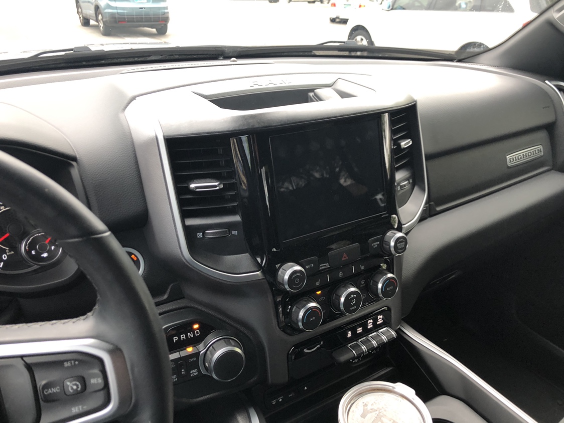

Dropped off the truck and I should have it back this afternoon. I’ll check back in then after I drive it some.
Gave me a fully equipped bighorn as a loaner. Nice!!!
