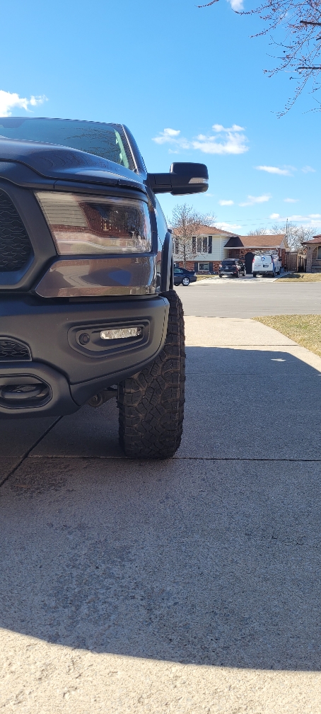

Wheels spacers?
You'd need to know how deep those pockets are and how long the factory studs are to gauge whether or not you're going to have to cut them.
Those would be them.

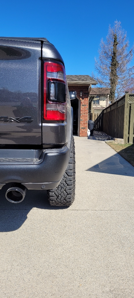

Nice, now i just gotta firgure out if i want to go with 1.25 or 1.5. Would i just go with the same spacers in the rear as well? depending on what thickness i choose?
I'm not an expert on the field but everything I read says that you should go a .25" wider on the rear spacers to even the track width out. The front track width is wider than the rear by a little bit. If that doesn't bother you, same thickness all the way around.
Oh i see, i just ordered 4x 1.5inch spacers... so i guess the correct way would be to do 1.5 in the front and 1.75 in the back?
From what I've read and my math, yes.

I just found the treads, yeah definitely going to go with the 1/4 different.
Now just gotta firgure out how to tell if my tires will rub...
Turn your wheels to full lock and measure your clearance from the tire to your fender. If it’s more than 1.5in then you’re good
I think with my current tires set up after a rough measurement I got about 1.3 or so inch left before the tire hits the mudflaps and etc. Now I guess I would just want to run .75 spacers if anything just for a bit better clearance, however... anyone know the stud length of the front wheels? Trying not to trim the studs if I can...
