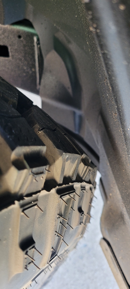

Cut fender liner bracket in anticipation of the 2" front spacers. Test fitted 1.5" and they were close. Some members don't have issue with 2" spacers and the bracket but because of the lift it pulled front tires in about 1/4 to 1/2"

Yeah I'm not 100% sure if I will rub or not, it's hard to say. Cutting the bottom bracket for the fender liner (which is only there for the Christmas tree style push pin) gained me probably 1/2" or so. 1.5 wheel spacers were close to that liner, so now with the 1/2" bracket gone I figure the 2" spacer will have wheel close to liner and maybe slight rub at certain angles or full cranks of the wheel.
