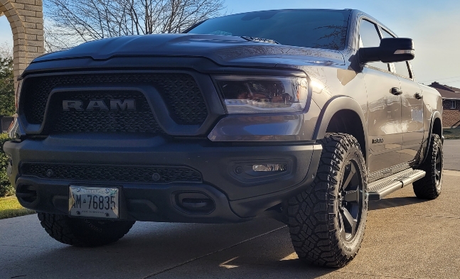

I'm running 2" have just an ever so slight rub only on drivers side while full crank in reverse only....not concerned at all
Looks good.
Is your truck lifted?
Stock rims?
Tire measurements?
Any cutting needed?
Did you use 2.5 rears to even out your front to back?
Also any other pictures from multiple angles?
Thanks a bunch.
Thanks.

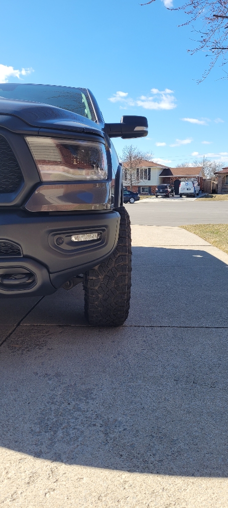

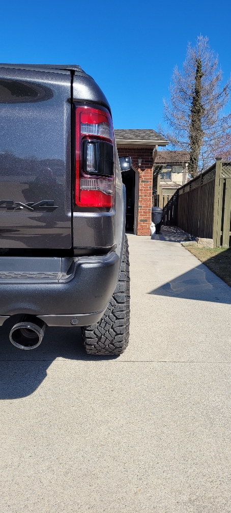

This is with 1.5" up front and 2" in the rear. The front track is already .4" wider than the rear stock. These are 295/55R22 (basically 35x12.5) on the stock black 22" rims (22x9 ET 19)

Looks good.
Stock rims?
Tire measurements?
Any cutting needed?
Thanks a bunch.
Thanks.
no lift
stock Rebel wheels/tires
non air ride
went with 2" all 4 corners. looks great in my opinion
very very minor rub drivers side rear of front fender liner...nothing to even worry about....only occurs if I am full lock in reverse left turn
no lift
non air ride
