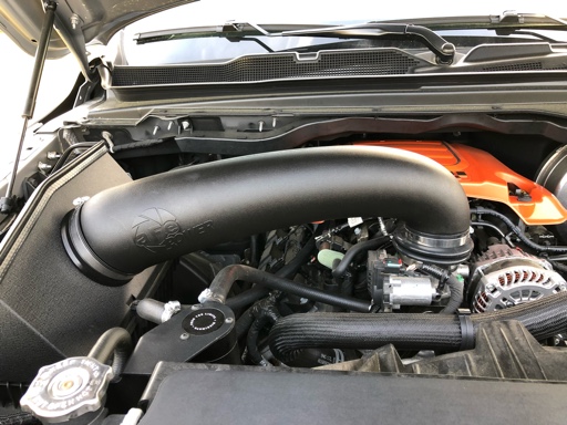

The lines that run from the can to the intake. Wondering if the box for the S&B will be in the way and if the lines will be long enough to flex around it. Possible for you to take a downward shot of your mishimoto so I can compare to where the S&B box sets?
Yeah, I’m sure there is room. Mine is routed around my procharger bracket/belt just fine. I’ll get a pic in a little while when I go out for lunch.

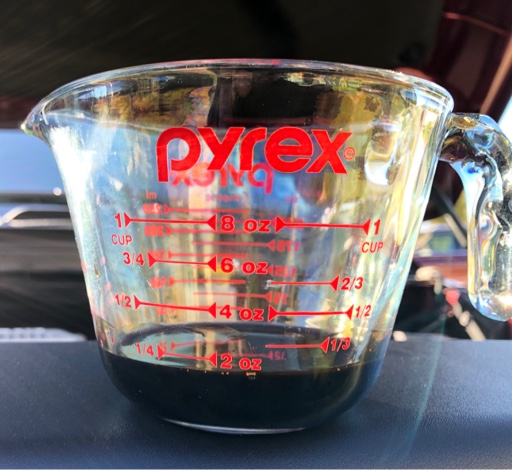

Here’s what I dumped from my Mishimoto can today after driving 1,855 miles. Installed at 7,048 miles and now at 8,903 miles. Just under 2 ounces of what looked like oil only, can’t see any water separation...
