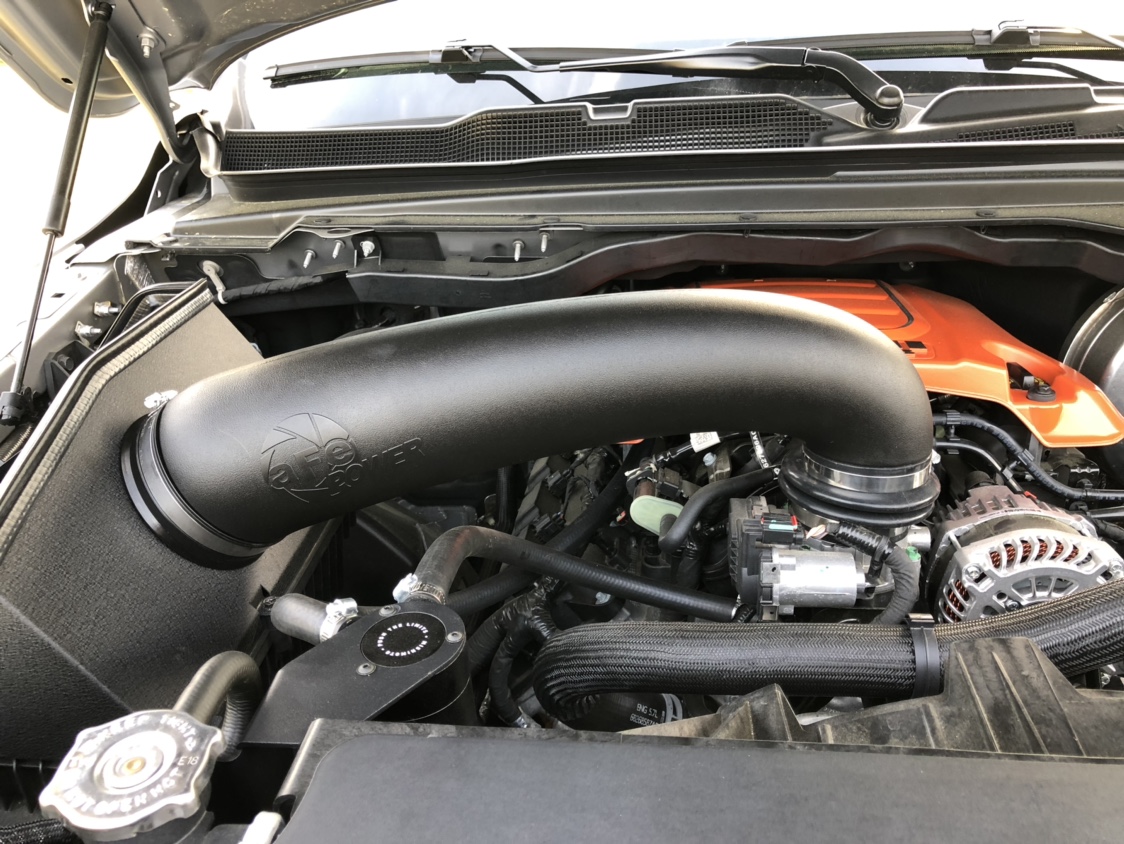

Yeah that looks pretty bad. I guess as the PCV lets the blow by go through the system it could accumulate on the backside of the throttle body if your doing a lot of idling like city driving. Pics of catch can installation.

I drain mine every 1500 miles and it only takes 5 mins to do. So not a bad deal for a cleaner engine. Your choice.
Looking at the Mishimoto website, I see it offers a drain kit for $35. How do you empty the can if it doesn't come with a drain?
Unscrew the bottom part. The drain kit just makes it easier
with the amount I have dumped already, from the factory oil, was about a 1/4 quart... I am glad I got one. I spent a lot of time cleaning my high mileage hemis before...
It’s put on real tight so you better break it lose and unscrew it one time before installing it. I bought a drain valve for an air compressor and and it screwed right in after I removed the plug in the bottom of the catch can. If you take the plug out and take it with you to match it to the valve. Home Depot or Lowe’s will have them for around 4.00 dollars.
Now that's more like it. Thanks.
