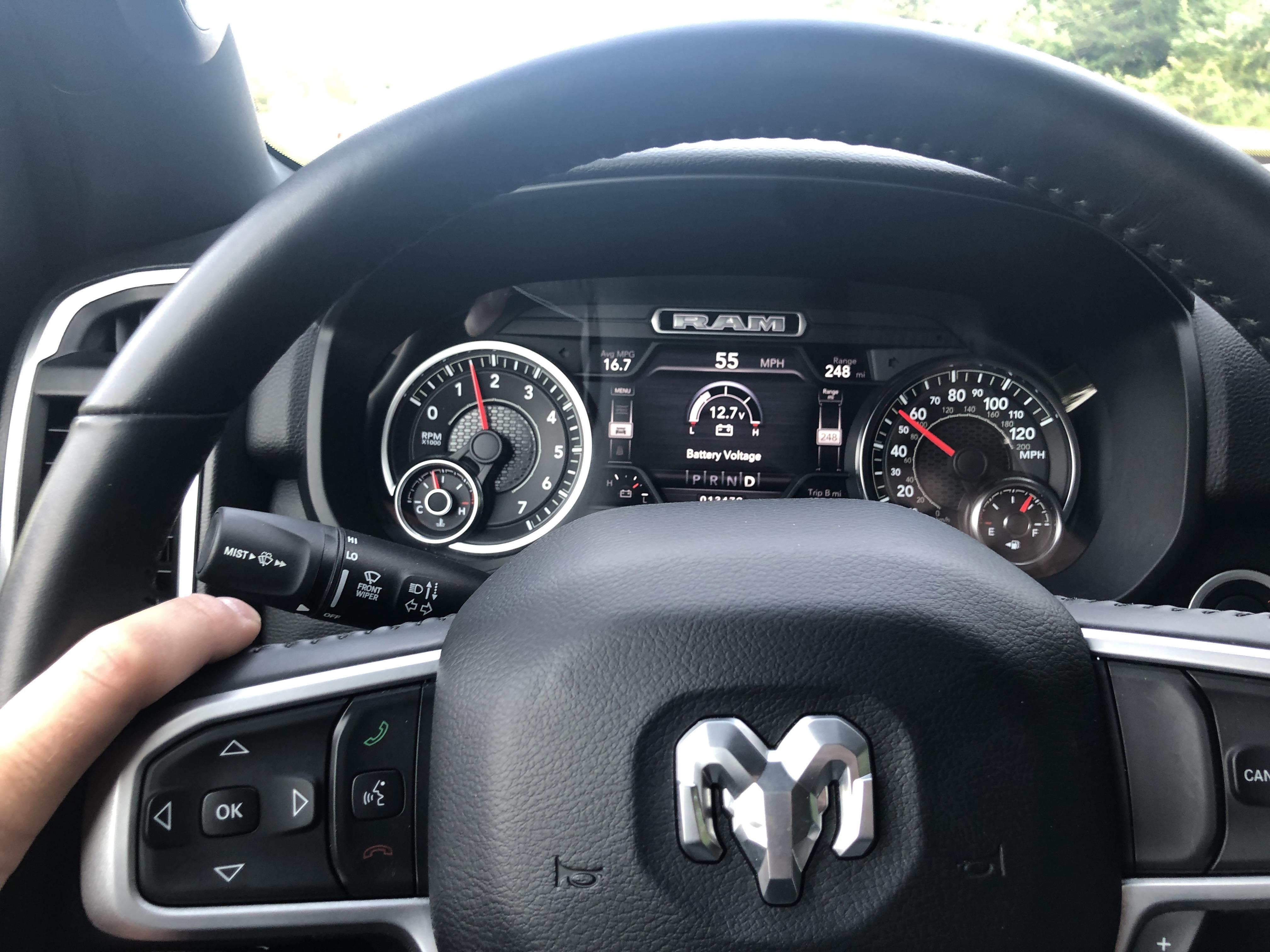

My Etorque seems to work just fine. On and off voltage is 12.7. I seen it a 13.5 running and the off 12.4 but right now driving it 12.7v. I wonder what a voltmeter would show.
Update. Played around. If I do remote start. Truck running and driving. Voltage is 12.6. If I used the push button start it goes up to 13.4
I done this 4 times both ways. Always the same outcome.
