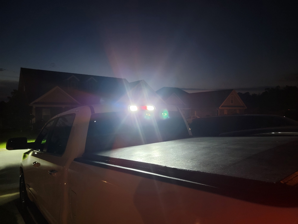

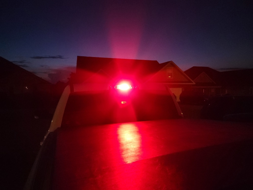

I just installed the diode dynamics xpr 3rd brake light led and the Lasfit cargo leds. Price was rediculous for one 921 bulb, but hot damn, it puts out some light and I know it'll last.

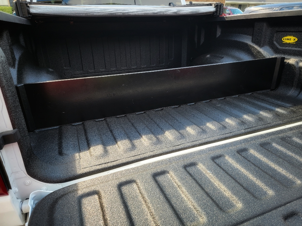

Also made a bed separator out of a 1x10 board, doubled it at the ends, and coated it in bed liner spray. Since this pic, I took it back off and sprayed some wall texture on it and then another coat of bedliner spray. Matches the line x much better. Foam strip at the bottom and sides to reduce rattle and snug up the fit.

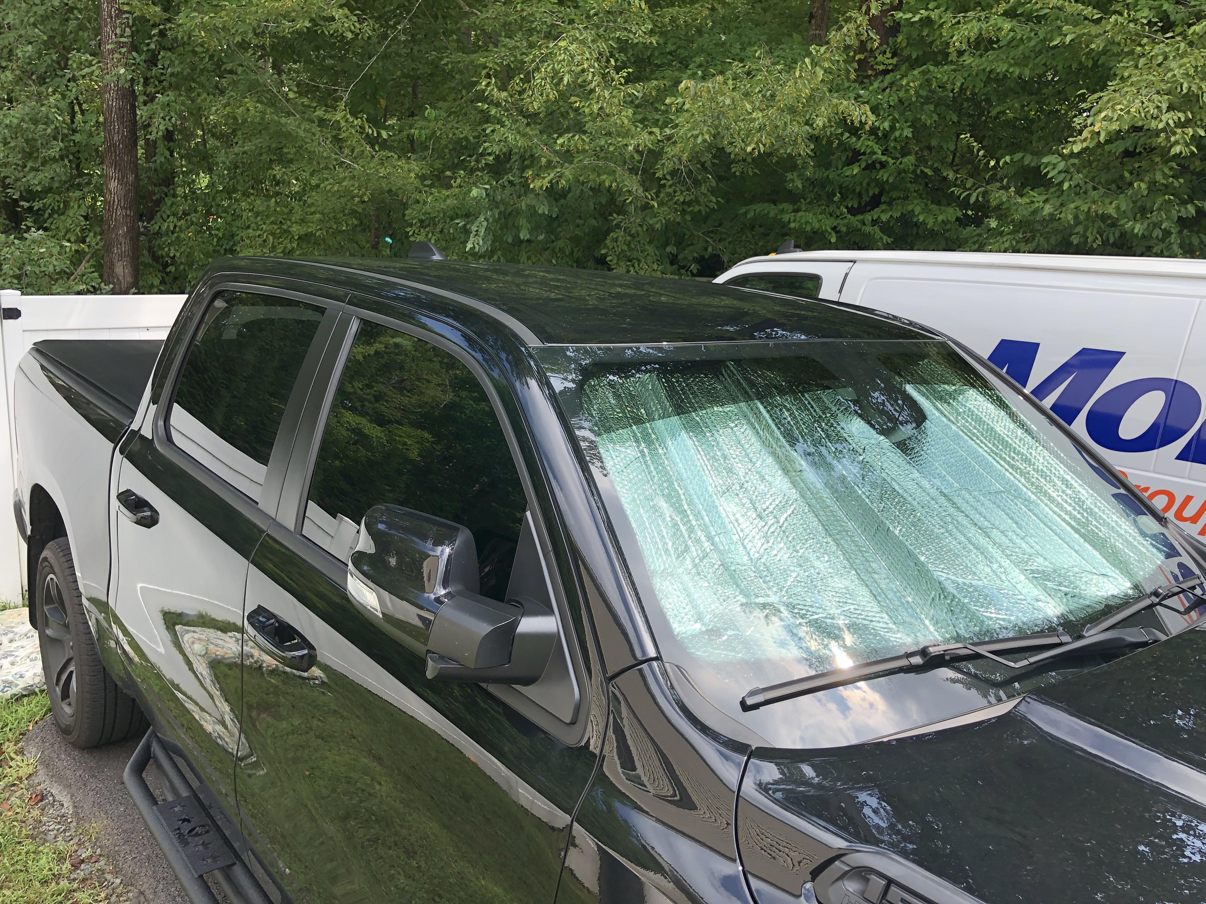

Windows tinted. Only got the upper window on the front done.tint shop wouldn’t tint the whole front. Wanted clear ceramic . They said to much water can get behind dash and screw electrical/ sensors up. On the newer rams. Sounds like they got hit with repairs or something.
Sounds like a lazy or incompetent tint shop. I just had my windshield replaced and retinted for the second time and shop had no qualms about doing it either time. Shop manager has a Gen 5 ram with full tint so i assume he knows the potential issues but they covered my entire dash and used a microfiber rope on the front inside edge of the windshield to catch water
The tint shop I plan to use mentioned this as an issue as well. BUT he said he would and could do it but could not discount the price due to the extra precautions/work involved. He is "discounting" all the other tint 15%. If you really want it done someone will do it!
