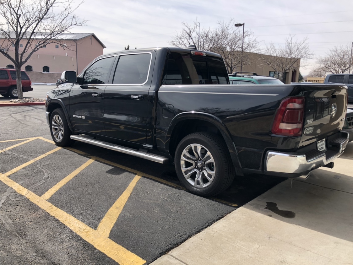

I’m infatuated with this new truck. Even dirty she is stunning.
Yeah, very nice looking truck, inside and out.
Just finished detailing the interior with OptiClean ( no it wasn’t required at all), sealed all interior glasses and trims and door panels with OptiSeal. Yes I am aware I have issues and OCD
