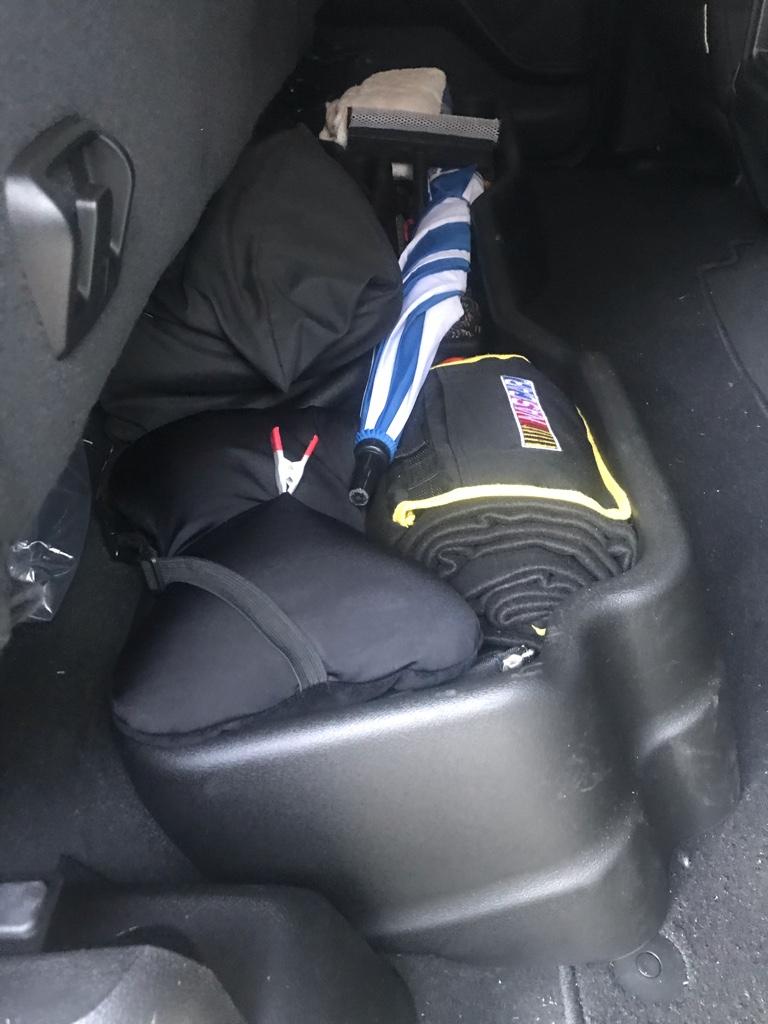

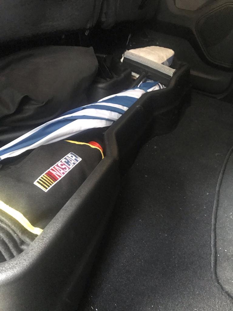

Installed this storage tray under the backseats of my 2021 Ram Quad cab today. Nice that it buttons up my storage and doesn’t get in the way of passengers feet! Paid $145 from this link: https://www.etrailer.com/Car_Organizer/WeatherTech/WT63SV.html

Please send a liner. I’ve only found the $300 one.
How does it stay put?
It has 1 strap and 2 strap openings on the middle of the back side that you can run around the mounts for the back seats. I bought a separate strap and used one for each side by strapping it down tightly. The bottom edge of the tray grabs the carpet really well also. With the 2 straps it is strapped pretty tight, especially with the things in the tray. Works well and nothing rolling around. I’ve had 3 people in the backseats also, no problem for their feet. They were all women though. Not that it matters, some women have feet as big as men! Works really well!
