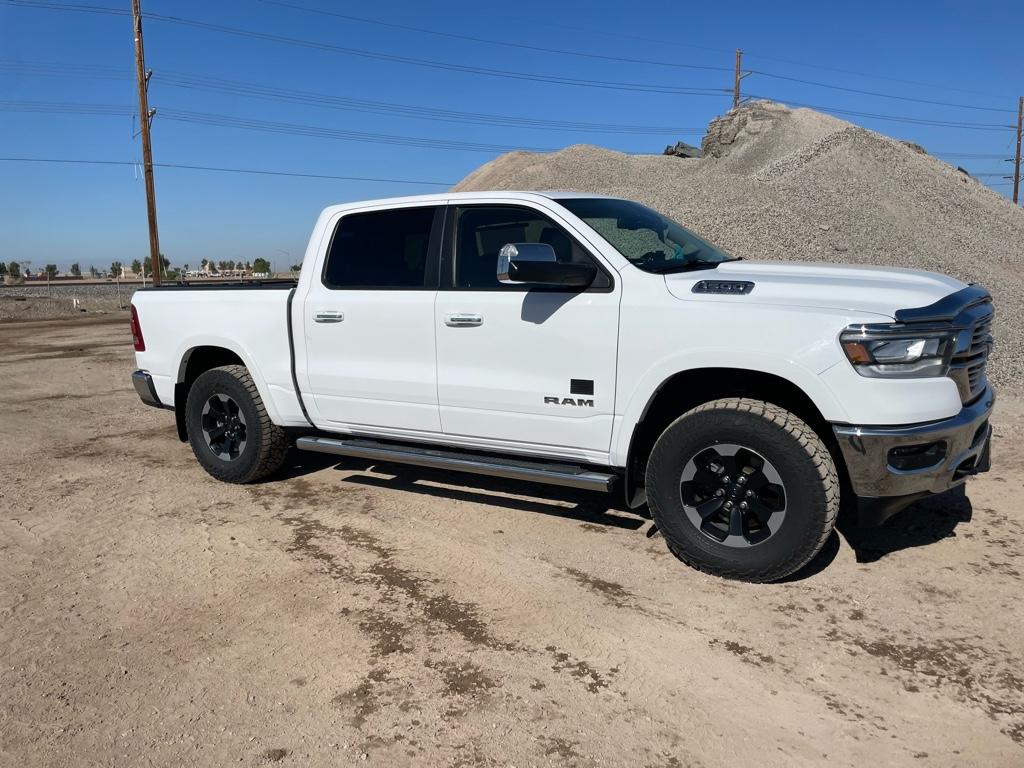

As I always state, my last change to the stance of the truck.
I put in all 4 ORP springs and reinstalled the 5100 shocks on setting #5 to provide a total of 3” lift in the front and 1” lift in the rear vs stock. Also installed Zone UCAs and had 295/70r18 Falken Wildpeaks put on which led to a small amount of trimming of the front husky mudflaps while waiting in line for alignment. The UCA is pretty damn close to the tire so I’m putting BORA spacers (.375” and .5”) on front and rear tomorrow for peace of mind.
Plugged into Alfaobd yesterday and got the speedometer dead on in short order and 2 miles of driving to test. Overall, I’m happy with the look and ride. For speedometer calibration I found a route that worked for me the first time. I pulled the circumference setting from the BCM, then calculated the variance of the trucks gps speed vs the speedometer by percentage and changed the circumference by the same percentage. Worked like a charm without having to play with the number.

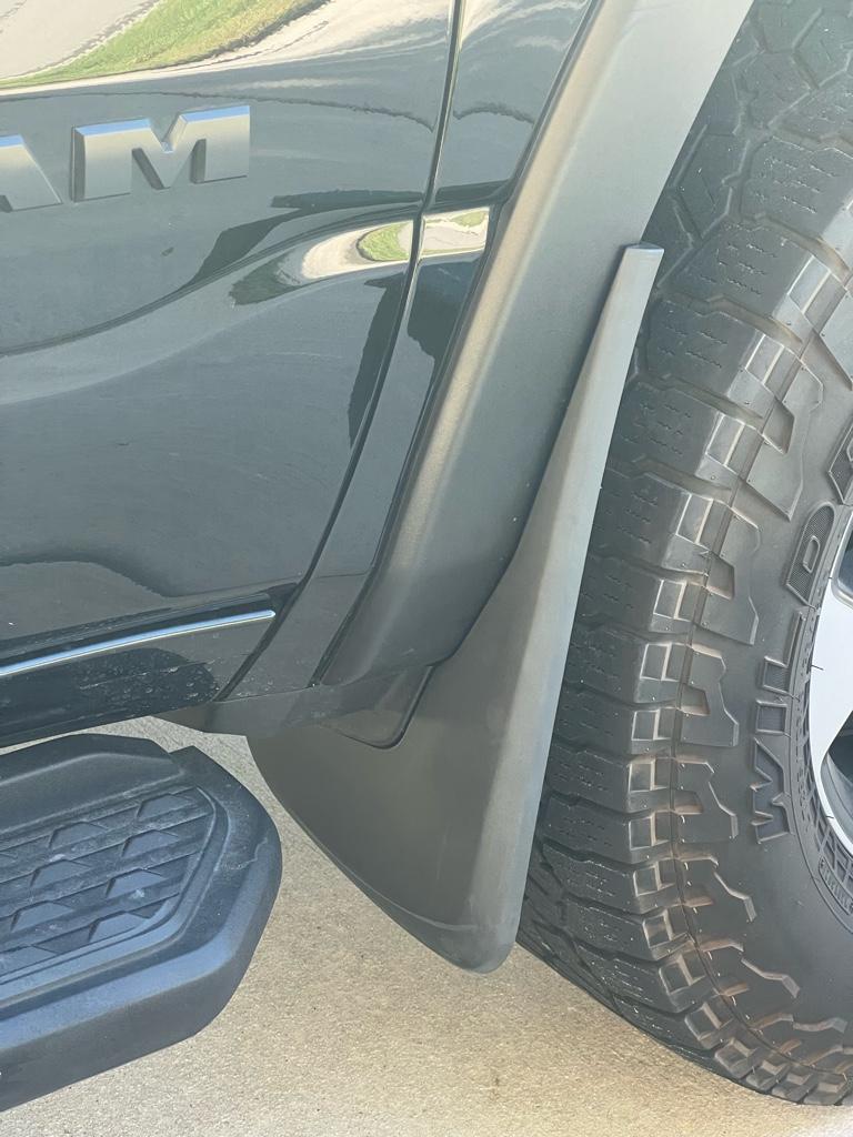

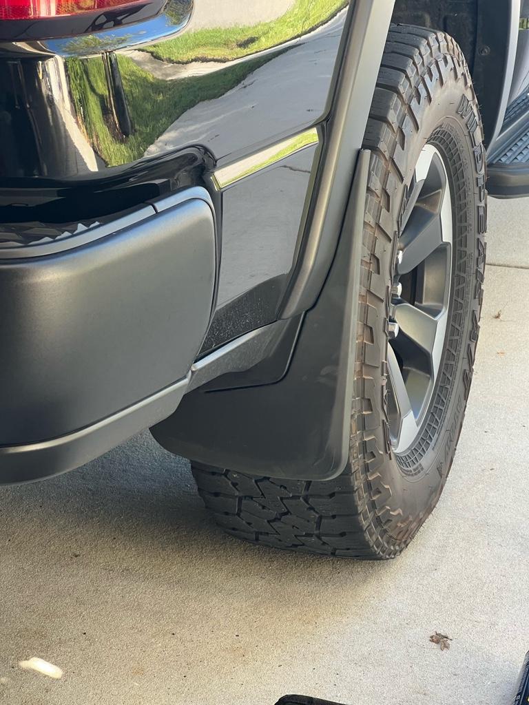

Just got these for $21.99 on Amazon.
https://a.co/d/biOLVwO
They’re $25.99 now but very similar to the Weathertech’s I’ve had on my last two Rams, at a fraction of the price. I’ll post some install pics tomorrow.
They look just like my Husky’s. At that price they’re worth a shot.
