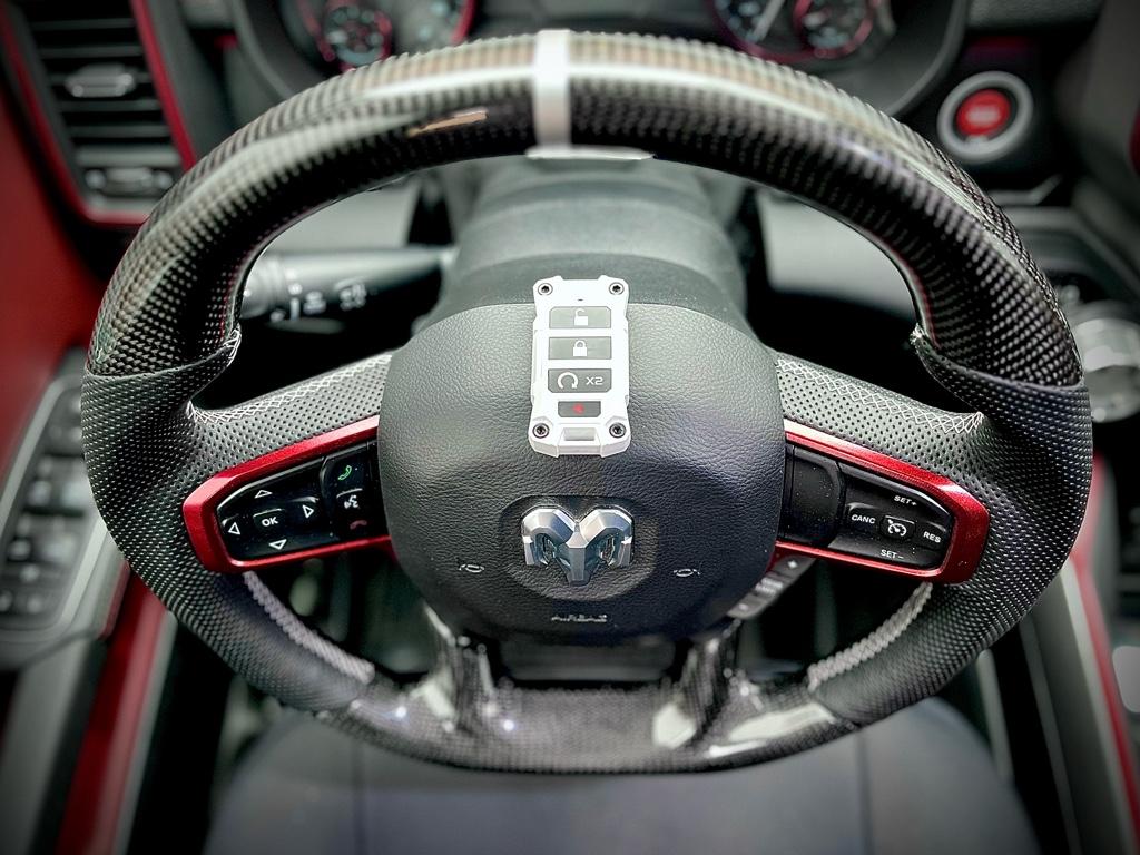

Hopped on the AJT key fob bandwagon
I had one of these back when I had a tundra because the tundra key fob was literally the same as the one they had for the Camry. The AJT one made it look like a truck fob.
That was before they had all these button color combos and stuff. But I also didn’t have a push button start. I’m actually really curious how the physical key fits into the new AJT ones. (My ignition key works with my ram boxes and my bed divider so I like having it with me inside the fob)
I’ll have to check his site and see if they show that part of the swap over.
Either way, looks good!! 👍🏼👍🏼

The key is held onto the bottom of the RAM fob by a roll pin. You can punch it out and put it into the AJT fob. That being said, if you use it all the time for ramboxes etc I would probably find a way to have it on the keychain rather than in the fob.

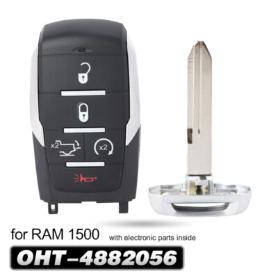

I tried the AJT cases. Works with my factory key fob internals, but the eBay fob I bought to get remote tailgate release, wouldn't work in it. Looks just like the factory fob, except the switches soldered to the board are just a hair taller than the factory fob, so the case pushes down on the buttons when screwed together.
Got a link or pic? Id love a tailgate release button...
yeah these usually work great when you're just swapping the oem guts as he does a really precise 3d model of the oem for the injection molds. but otherwise those subtle differences can ruin it. sux.
Adam replied to my email. He said to try sanding a little off the back side of the button insert to make it work. So going to try that. Instead of taking my wife's fob back apart, I just ordered another case from AJT.

This is the one I bought.

so follow up question, when you do have the key inside the AJT fob, does it stay put, or does it rattle around in there making the fob sound like you have tic-tacs in your pocket? :ROFLMAO:
I also notice that Adam is now actually coloring the marks on the button faces which is excellent. the ones i had were black buttons with embossed symbols but they didn't pop out at you, so when like the wife grabbed my keys she's have to kinda give them a 2nd or 3rd look before picking the right button. looks like thats not an issue no mo. are his buttons still also injection molded plastic, or rubber now?
I can send a pic of the buttons, they are really nice IMO and the key is held in place by a raised plastic outline of the key shape. No noise at all or Id throw it away.
