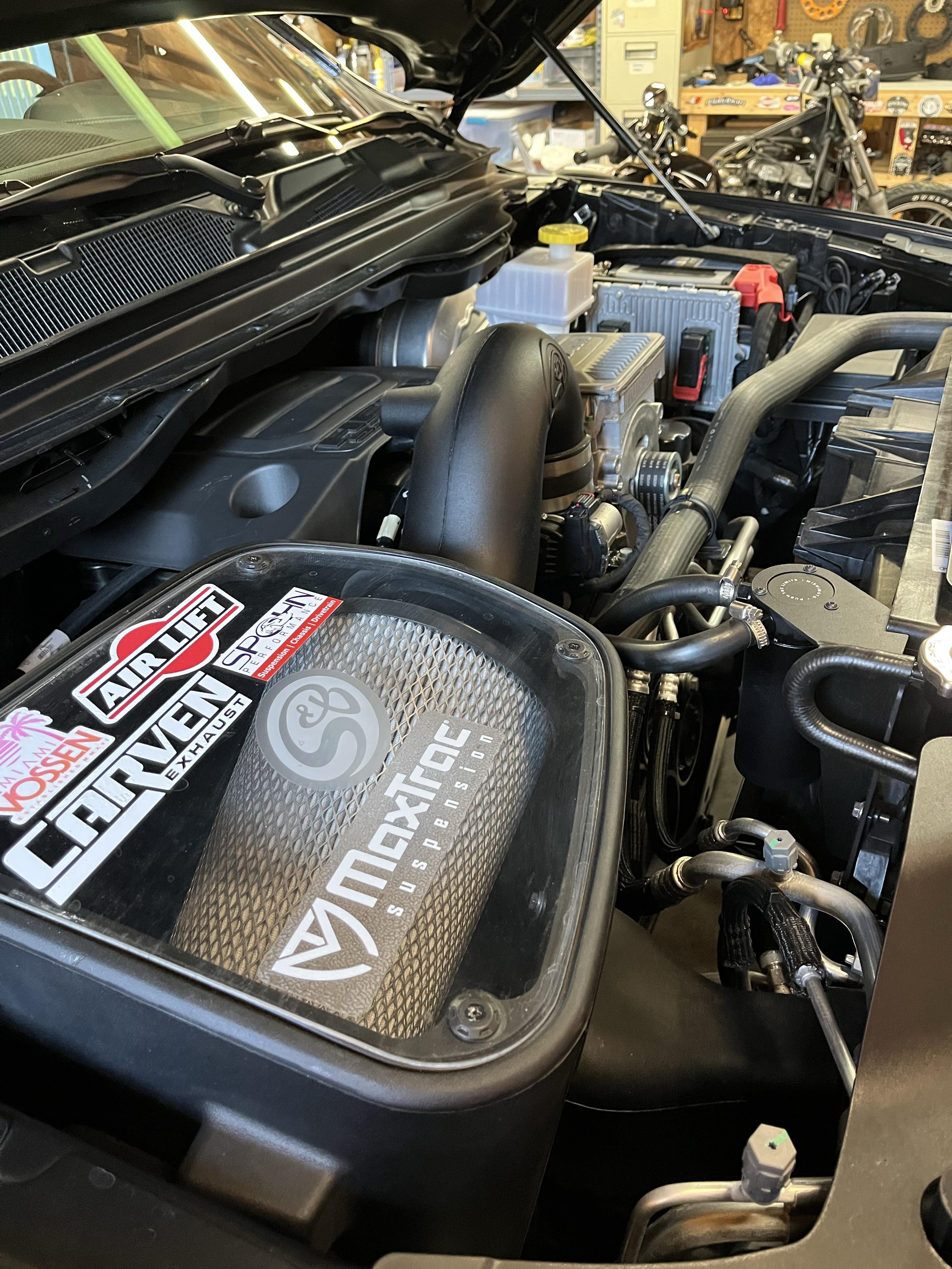

They seemed to be the same all over about $210. I went this route because it is known to clear the cold air intakes (doing that next) where the engine mounted style does not clear them. That being said the mishimoto kit is extremely high quality, everything was packed great, fit great, instructions were clear and it installed without any issues. It’s expensive but I dont mind paying for quality. Buy once, cry once. 😎

The special ram mounting bracket and ease of access is worth the price imo
The one I use has a Hemi specific mounting bracket, and as for ease of access, it has a drain valve on bottom. No need to take it apart to empty, and since it sits next to engine, you don't have extra hoses running up to radiator area that definitely dont look factory.
Plus it works great with the best looking CAI made by Vararam.
And I can just reach over my grill and unscrew it to empty. No need for a ladder or to have to bend over my front end to access. Or a need to place a container under the drain valve to empty it.

Separates the oil out of the crank case vapors that normally would be introduced back into your intake. Then onto your valves to burn off per emissions.
Some high end vehicles come with them from the factory. And are plumbed into the oil pan. So there is nothing to empty.
It’s just a way to keep your engine running at an optimum level for longer and helps reduce the need for valve cleanings.

You don't plug any holes. The air still flows in the same way, the can just catches droplets of oil that are in that tube. The amount of oil that you capture is going to be relative to your driving habits. some guys may catch a few ounces, some guys next to none

I get about 2oz every 1500-2000 miles on my 2020 Hemi.
And it catches more than just oil vapor. There is also water and fuel that gets collected as well. Stuff I wouldn't want in my intake, or even dumped into my crank case and mixed with the oil.
The last two vehicles I had a catch can on, I would capture about a couple of ounces between oil changes. Having just installed one on this ram, I would expect to see about the same. I just recently changed the oil so I guess I will find out next year
If you live in a cold climate and have a short commute. Moisture will build in the can, meaning you will need to empty/check it more often.
On my last truck, after 5k miles I had about a 12oz beer glass full.
