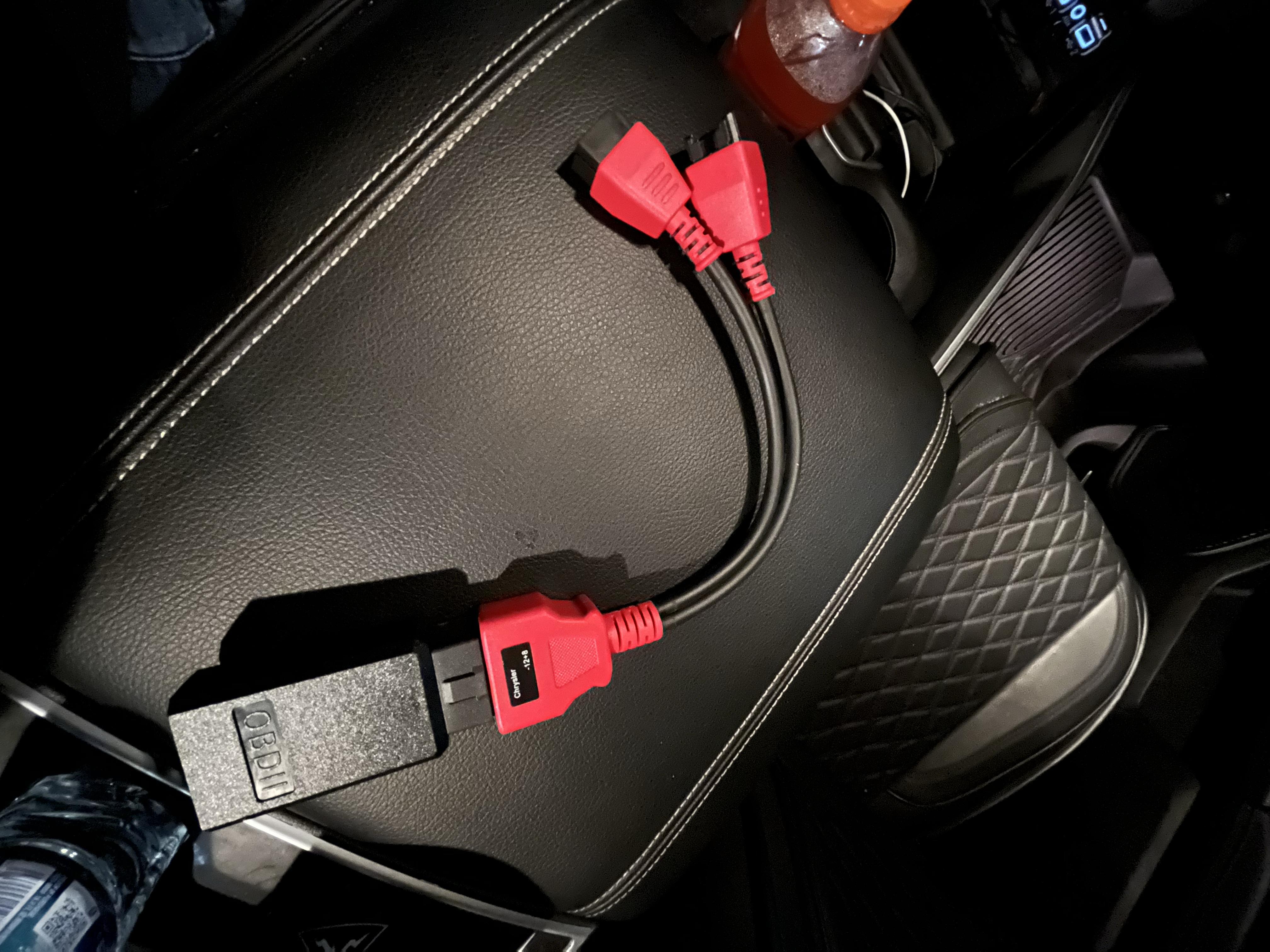

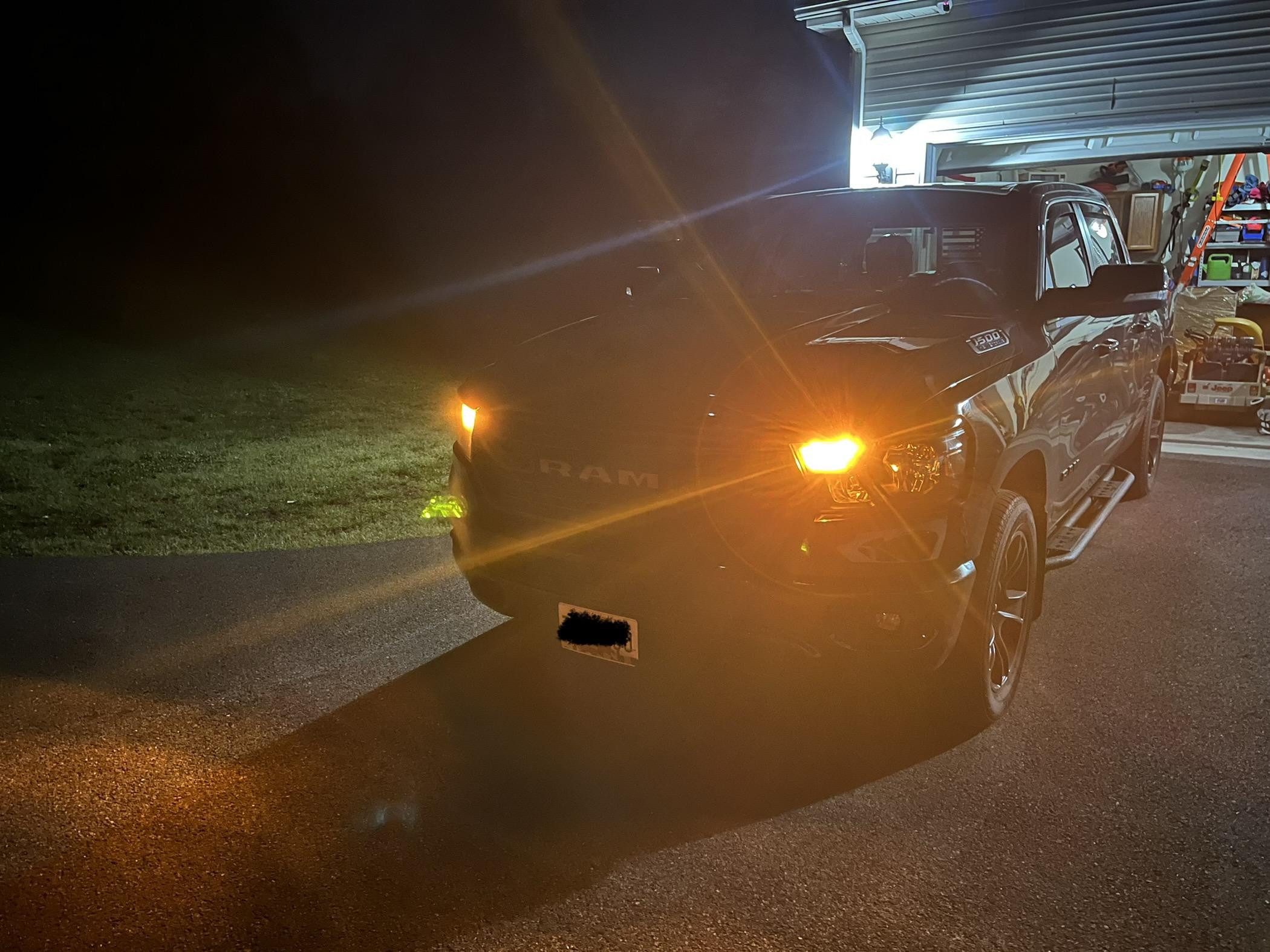

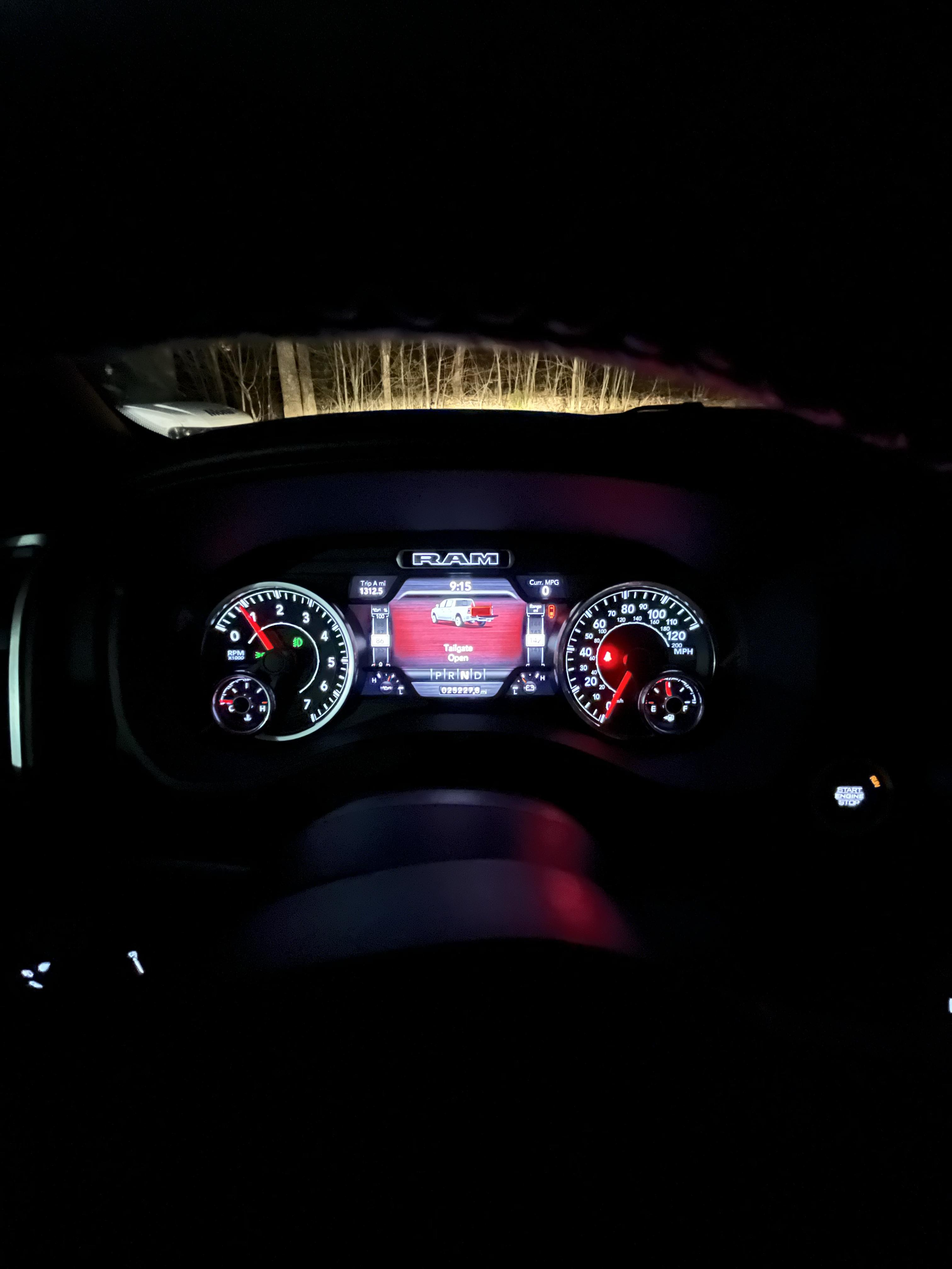

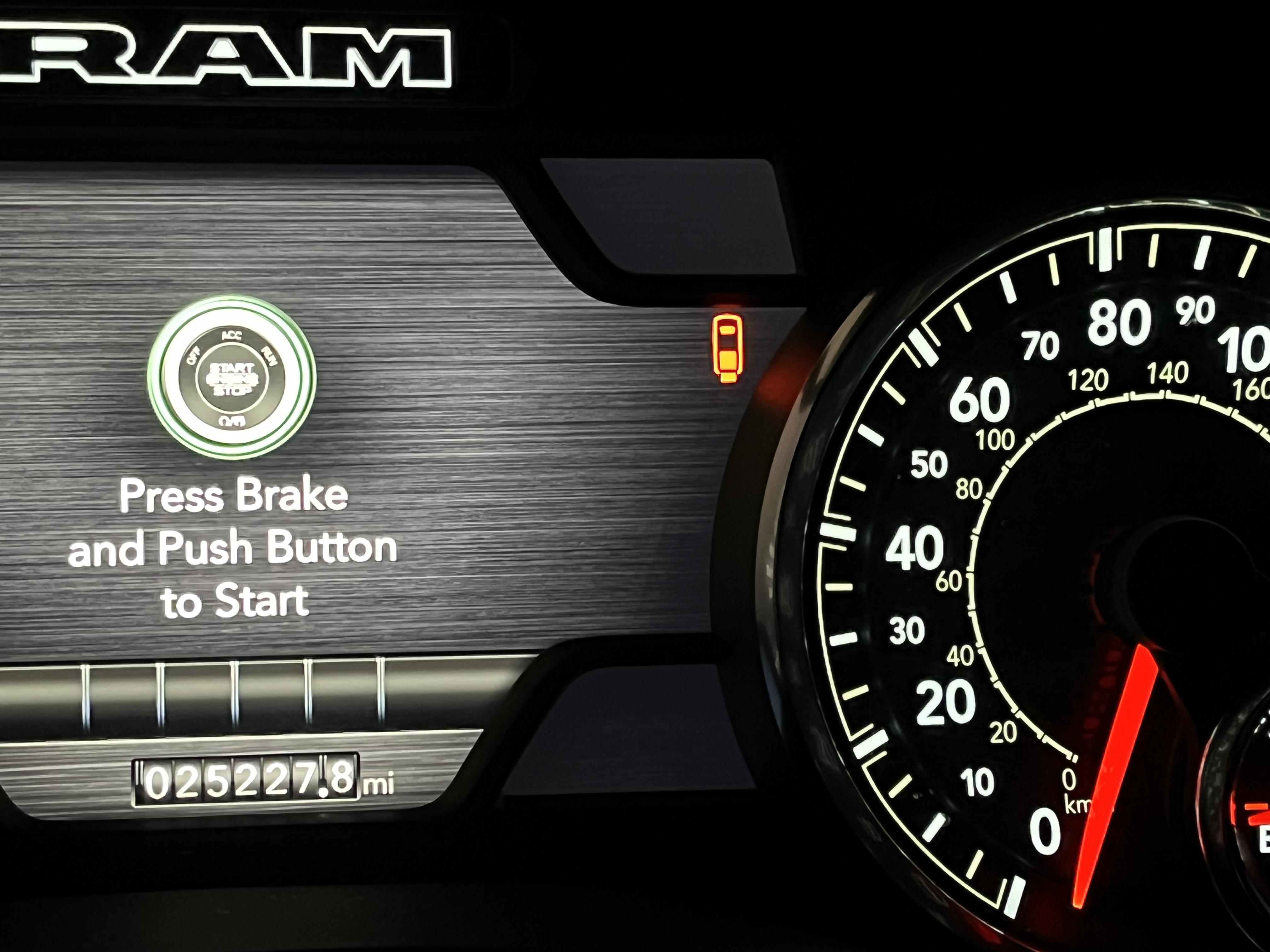

Played with Alfa obd. Added the tail gate ajar warning and changed my drl to front turn signals. Placed another phone on sensor to keep head lights off during the night. Literally took me few mins. With the help from little research before I started. Thanks to others on here for there posts.
