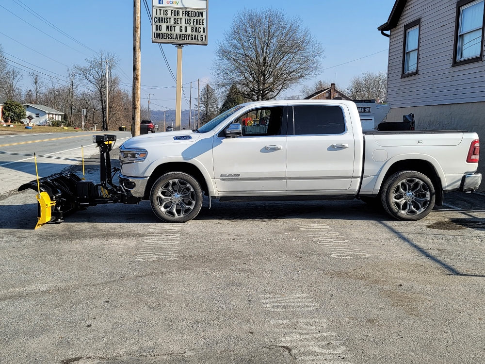

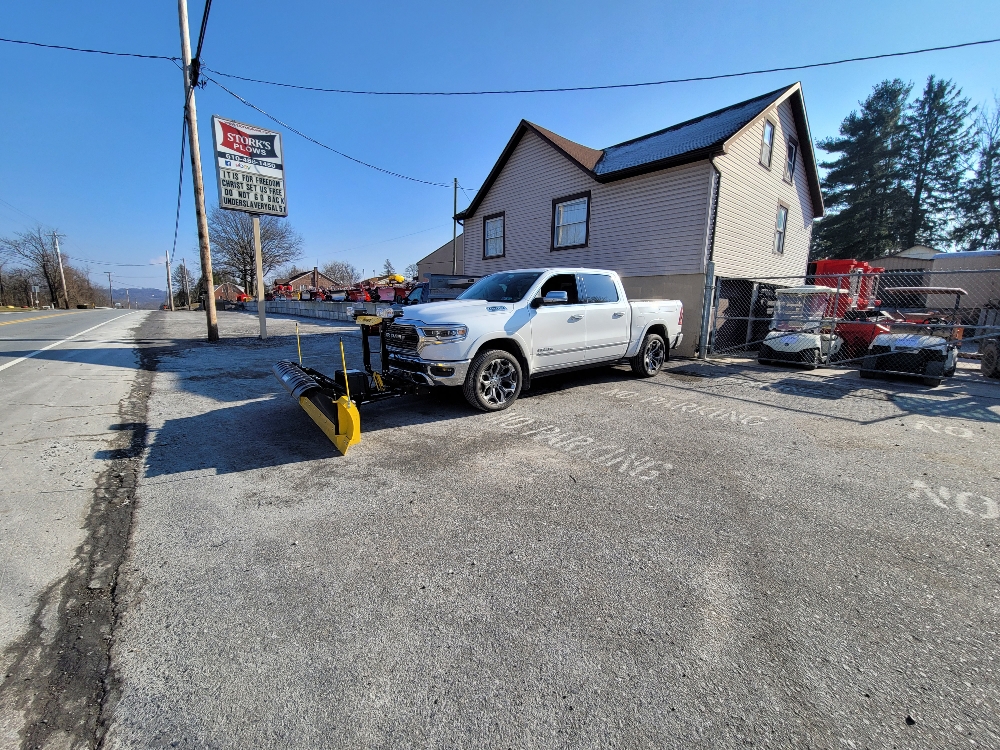

Bumping this thread I finally got my Western HTS installed today, very happy how it turned out. Truck drives great with it just need some snow. Haven't had much so far in my area that averages 150"+ a year. Thanks to all that took the plunge before me.
When looking at the pictures you posted I noticed a round pipe/bar that it looks like the dealer installed over the blade and painted black. What is the purpose of this? Is it to avoid blade wear or scratching concrete as a normal blade does? Does this create an issue of not removing the snow and packing it more? Or is this mainly used on gravel drive to avoid digging into drive? Just curious.
