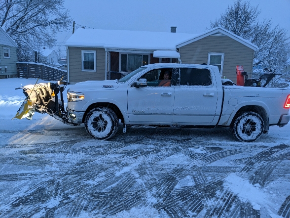

Bumping this thread I finally got my Western HTS installed today, very happy how it turned out. Truck drives great with it just need some snow. Haven't had much so far in my area that averages 150"+ a year. Thanks to all that took the plunge before me.

Good a used series 1 snoway installed. Look how far out in front of the truck it is...
