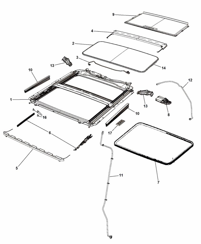

Alright, here we go.
Stopped by the body shop because I was sick of dealing with the dealership as the middle man. The body shop folks were eager to open the truck up and show me what they found.
BLUF: replacing the sunroof won’t fix the issue. The sunroof/chassis design is 100% the issue here, folks. They just aren’t compatible.
The attached image is not of a 2019 Ram assembly, but the idea is the same. There’s the drain tubes at the front and back to allow water that gets through the seals to drain harmlessly outside the vehicle. The tubes at the rear of the assembly, for whatever reason, are in fact going UP from the assembly, therefore preventing gravity from doing its job. The water pools up and drains into the cab. The 2019 RAM HD with sunroofs are all built this way, according to the body shop. He’s seen a large number of new Ram water leaks and thought he was fixing them until mine came back with the same issue two weeks after he worked on it.
I’m at least relieved to know what in the actual heck is going on with the truck. All it took was a field trip directly to the body shop and a little show and tell.
So where does Ram go from here to rectify this design flaw? Who knows. Replacing the sunroof won’t fix this. I’d reckon they have to design a whole new headliner and reroute the tubes to make sure they are always working their way towards the ground. Recall? Not sure the answer there.
