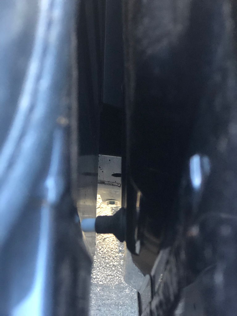

Looking at mine, looks to be the same problem. What do you think? Look to be incorrectly installed?
It is definitely not seated properly. The round part (grommet) should be sitting flush with the cab. Basically the back portion of the grommet should go in the hole, creating a seal. I was able to reach up from underneath the truck and correct it.
Thanks! I agree. It kind of looks like it was installed backwards.

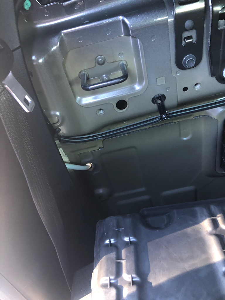

With finding a solution for the brake issues I've been fighting decided to check in here as well. Built 8/18 - picked up 10/15 and just now checked...yup, both grommets are out. Was able to put drivers side back in but passenger side tube is pushed too far out and grommet won't slide on tube to put back in. Going to check under seats for dampness/rust/etc. Auughhh...guess I'll peek in on all the threads here.
EDIT: Checked for water behind both seats and no water damage...whew. Attempted to pull the carpet off and get sub out (that's the side that won't go back in) but don't have a lot of time. Put everything back together and let them do it when I get my brakes fixed in a few weeks.

Did you just take out two bolts to put the subwoofer down? Mine has subwoofer so I can't see the drain tube...

The factory sub has four bolts. Two at the top and two at the bottom that wrap forward into the cab. You'd need to pull the rear wall carpet up to get to them if you're not removing the seats.

Thanks. A little bit difficult to access. But at least I know where to check if it leaks.
