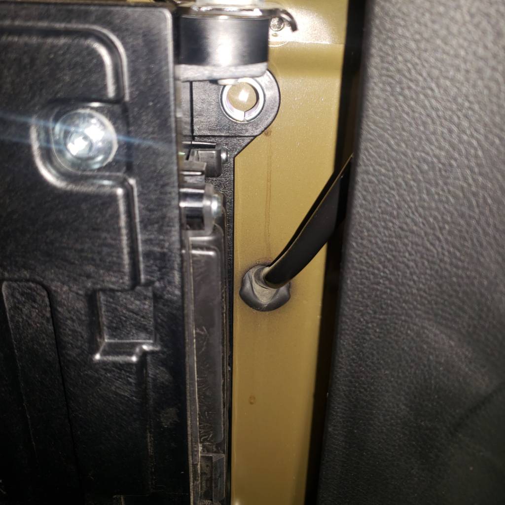

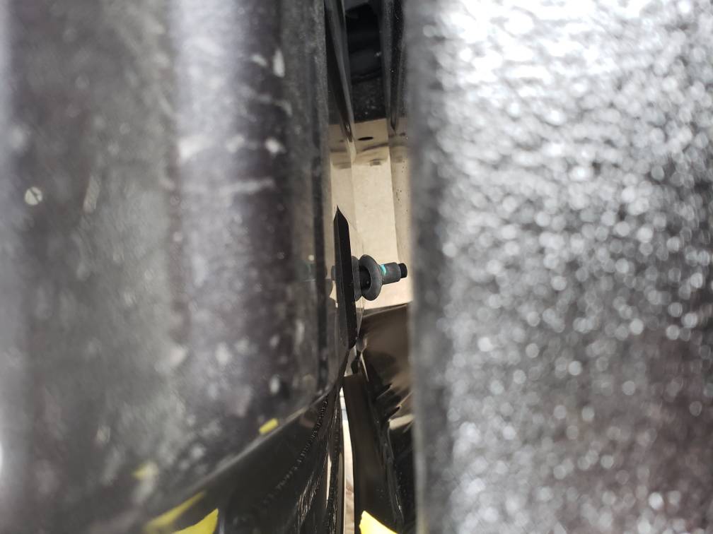

Where/how does one check? I've see plenty of photos on this thread, but too zoomed in for me to tell.
First pic is the inside, second is the outside...
Just to clarify using @tonyplants pic this is a downward looking angle between the cab (on the left) and the bed (on the right). You'll have 2 drains and the other is on the passenger side in the same position. The drain tube should protrude slightly out of the grommet.
Correct, these pics are the drivers side. The second drain line on the passenger side is pretty much same setup. The grommet in this case is not seated correctly. It should sit flush on inside and outside of cab. Search for thread, "Under Water"...you'll find more info there regarding our issue...

Note that the first picture inside shows a water leak stain from **above** the grommet. You may have a rear window leak also.
I pointed this out when I dropped off for Service Tuesday. I also sent them this pic.
