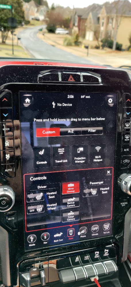

I am using the tazer dt from my understanding the has the security bypass in it and has the option to turn cargo cam on and I have done that but the cargo cam option still does not appear.... My main question is will the cargo cam option appear even if it does not have a source inputting into it. because I have heard that the camera inputs can be different on these trucks and pins 21 and 22 might work for yours but it may be 24 and 25 for mine. I have put the composite cable in 21 and 22 and turned on cargo cam in the tazer dt but it still doesnt show up so my only thinking is that it is like a tv and will only give you the option when it is getting a input that's why I was asking at what point the cargo cam appeared on your screen

I doubt it would be display causing issue, perhaps issue with BCM???? the cargo cam button should show up by just enabling option in tazer without camera, correct??? If so when I get a chance I can try it. I would just want to make sure if it works the button would disappear when I disable option. It would be nice if zauto hung around the forums.
@sutterboy Okay just tried it on my 12in screen and I got the cargo camera button after I did a full reboot with the Tazer, did you try that?
did you do a full reboot on the tazer or a full reboot on the ucconect screen itself? I have done multiple full reboots on the tazer and still nothing. I feel like a option my truck has is causing this not to work do you have the cd player installed on yours?

Just an update I was able to remove cargo cam button, just made the change in tazer and performed full reboot in tazer and cargo cam button was gone. Basically the same way as I added cargo cam button. Now I have to get enough guts to tear out my screen to add cable for front camera.
