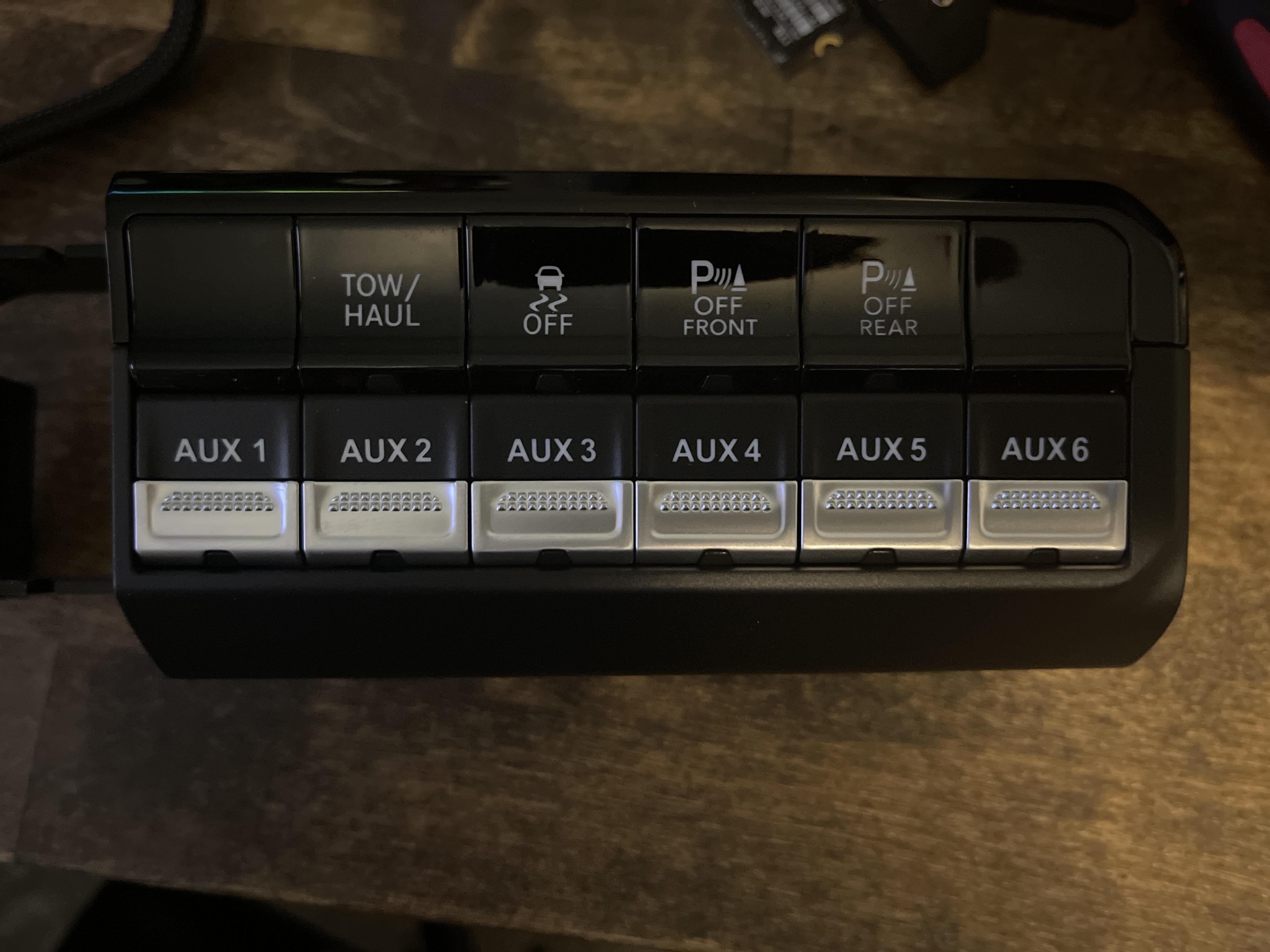

Just curious what part number this unit is. I found on the site a decoder sheet but part numbers dont appear to match images of the switches I ve been seeing. Any help would be great.

I believe you need:
68376640AE
From this post here:
This is 68376640AE:
68476031AB has the diesel exhaust brake button instead of the traction control button, so you don’t want that on a 1500.
68376640AE will work for 2019-2022.
2022 Rams DO use a different part number for that same switch bank, but only because the top row of buttons circled in the pic have a matte finish instead of gloss.
Does anyone know the part number for the ones with the matte finish?
68376640AE - top row is glossy
Does anyone know the part number for the ones with the matte finish for a 2022?
Not sure which one it is because they don't tell you :censored: https://store.mopar.com/v-2019-ram-2500--laramie--6-4l-v8-gas/electrical--switches scroll down about 2/3 of the way and good luck. Maybe make a list and take them to a dealer and see if they can figure it out. Or go to a dealer and see if you can see one in a truck and have them look up via the VIN.
