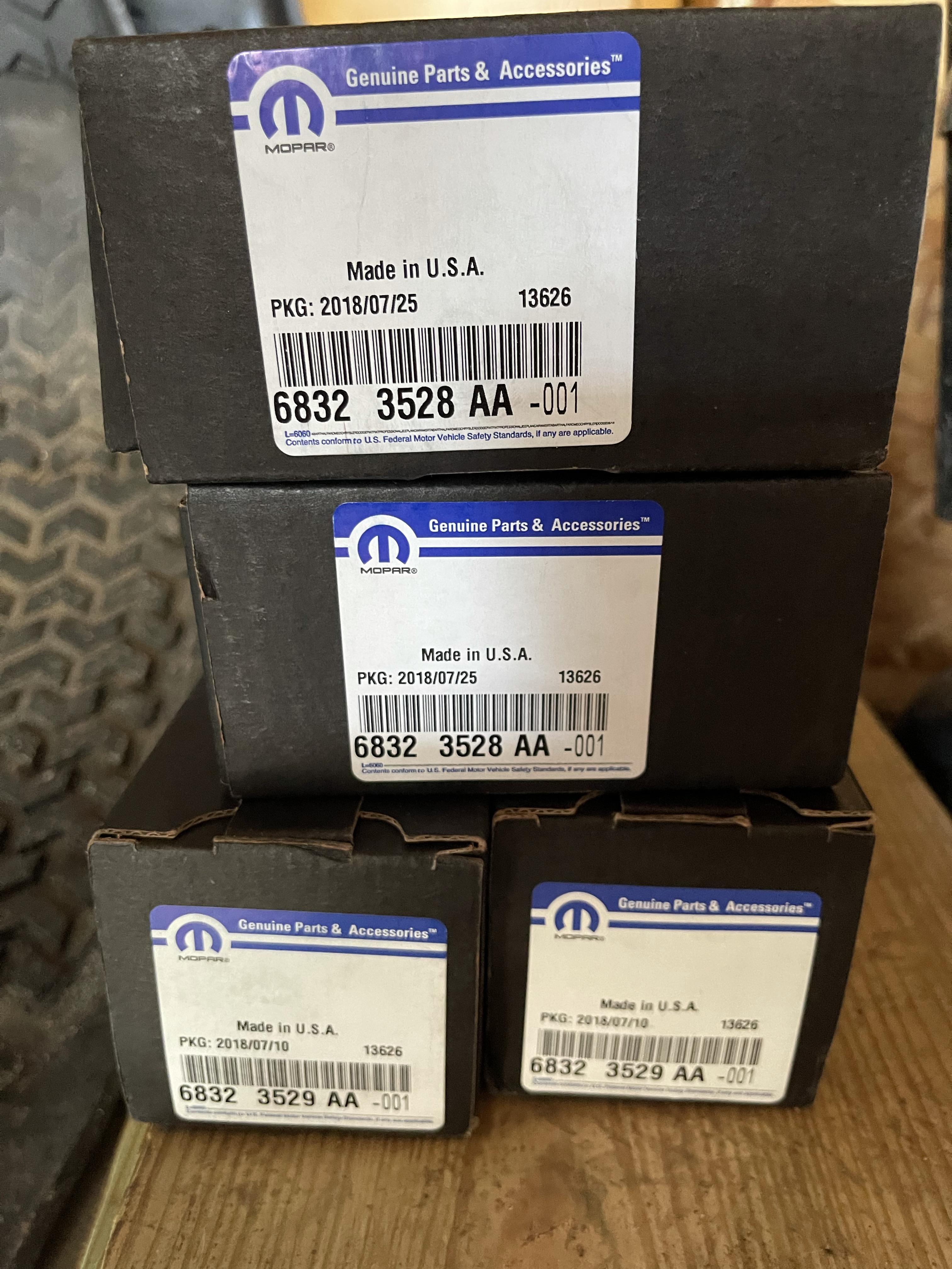

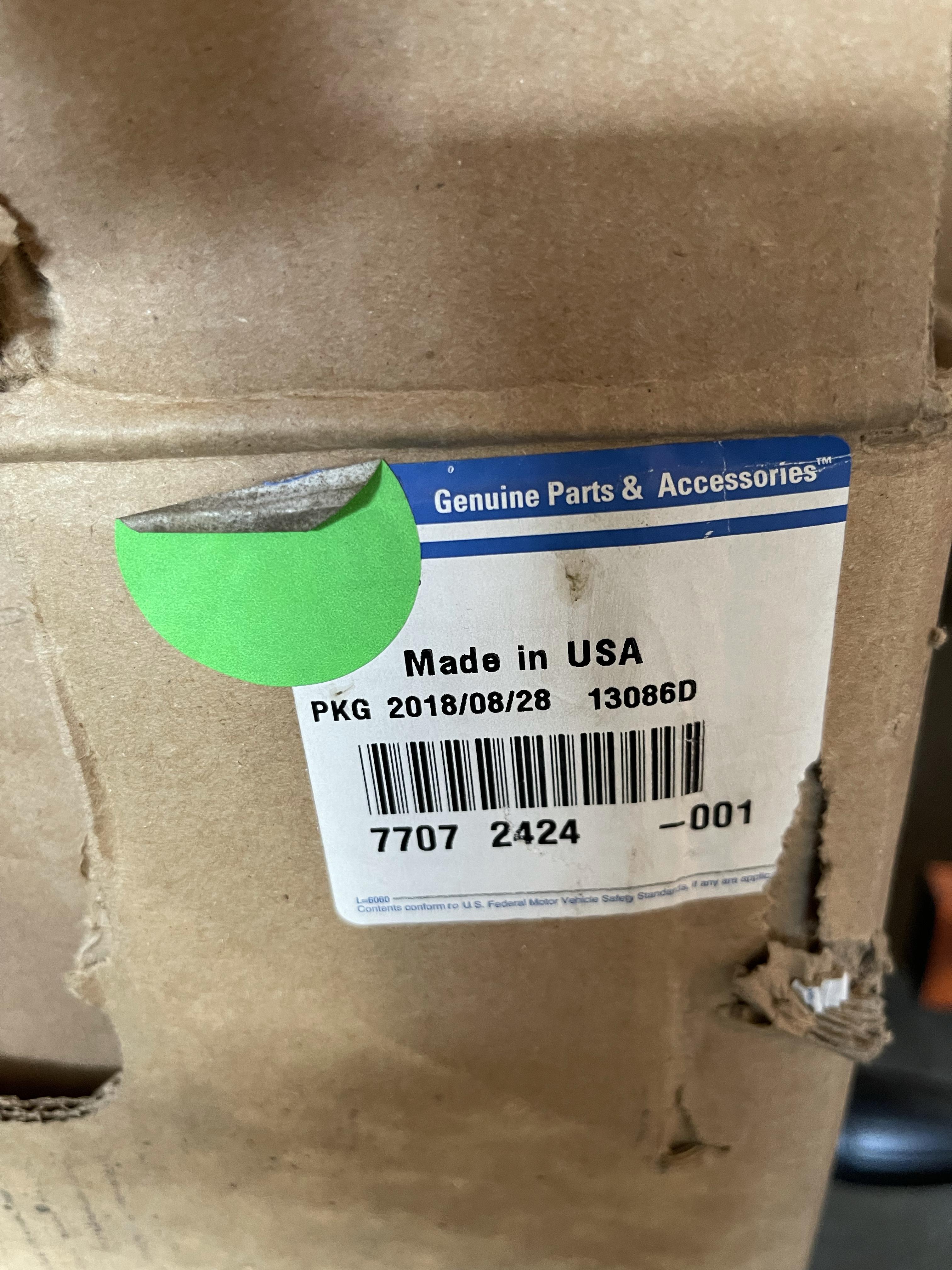

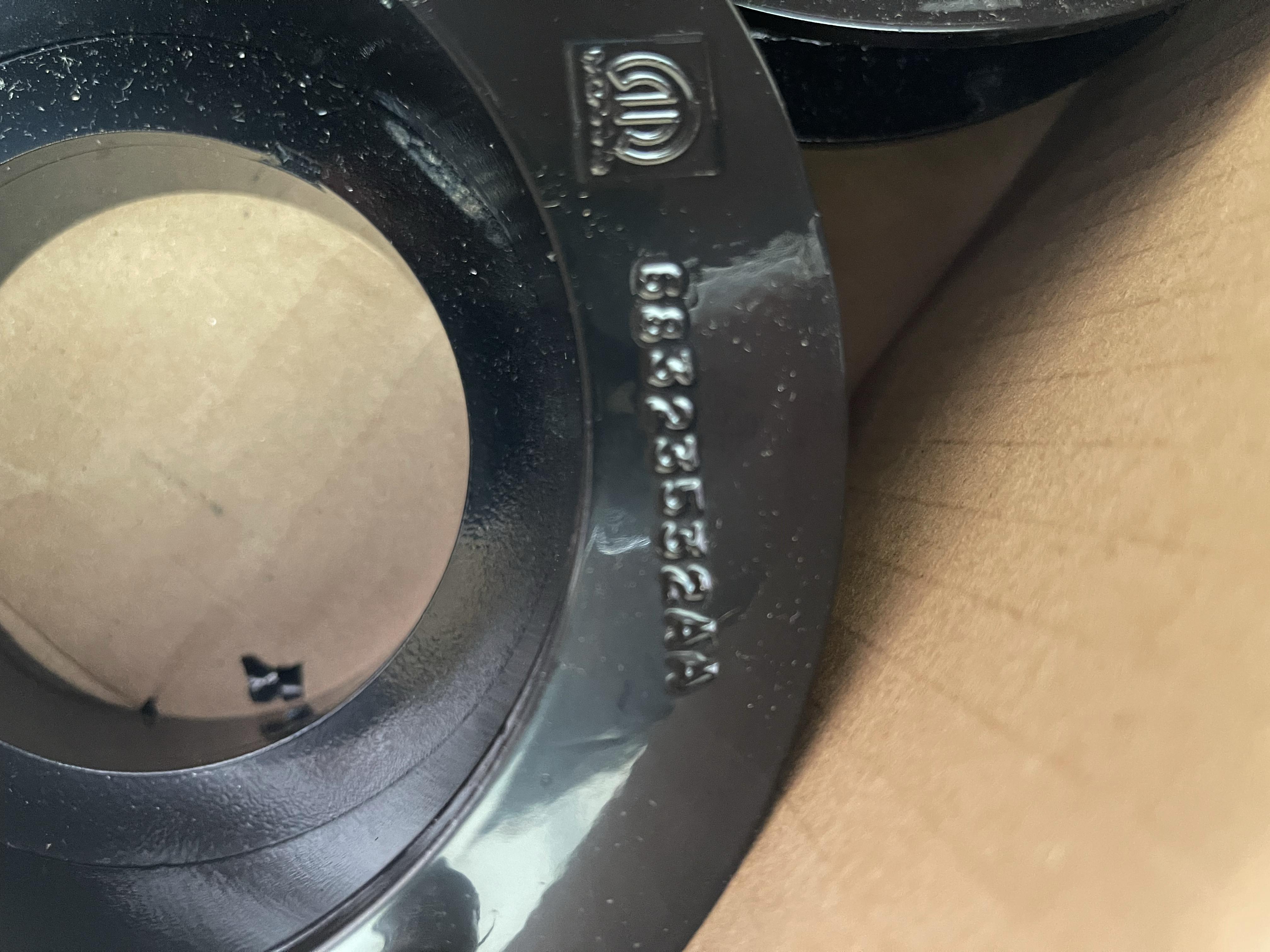

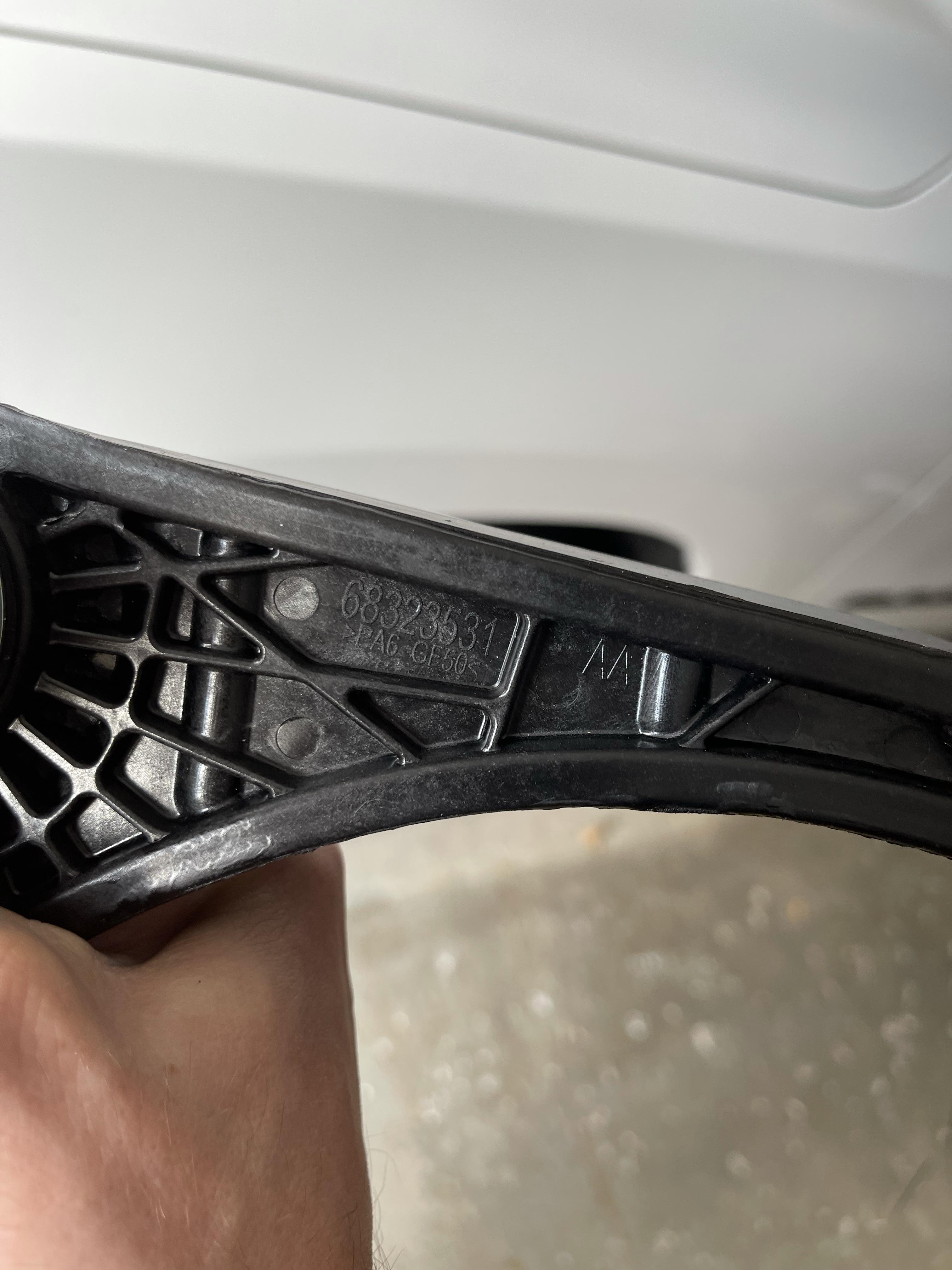

Some sites are saying 77072424 does work with my 2020 and some say it doesn’t. The fox shocks are 68323528aa and 68323529aa. Is that all correct?

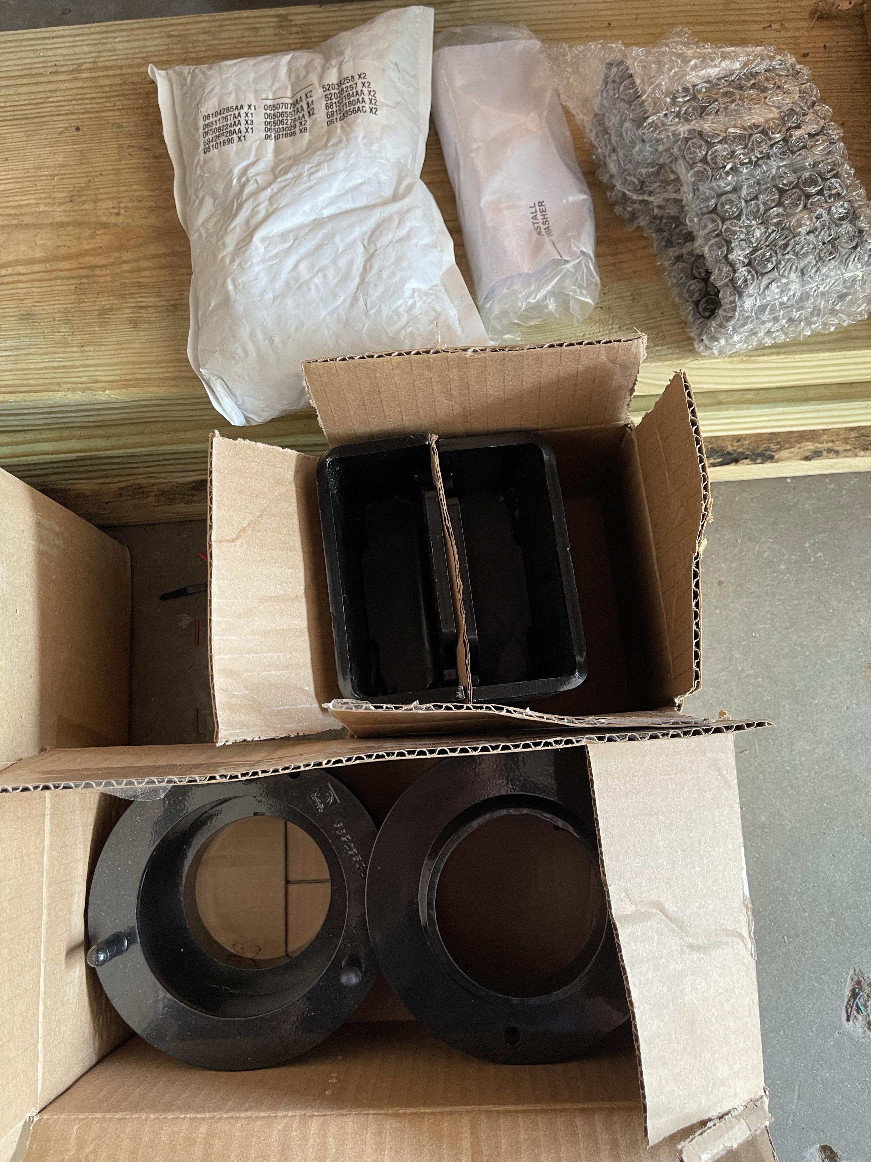

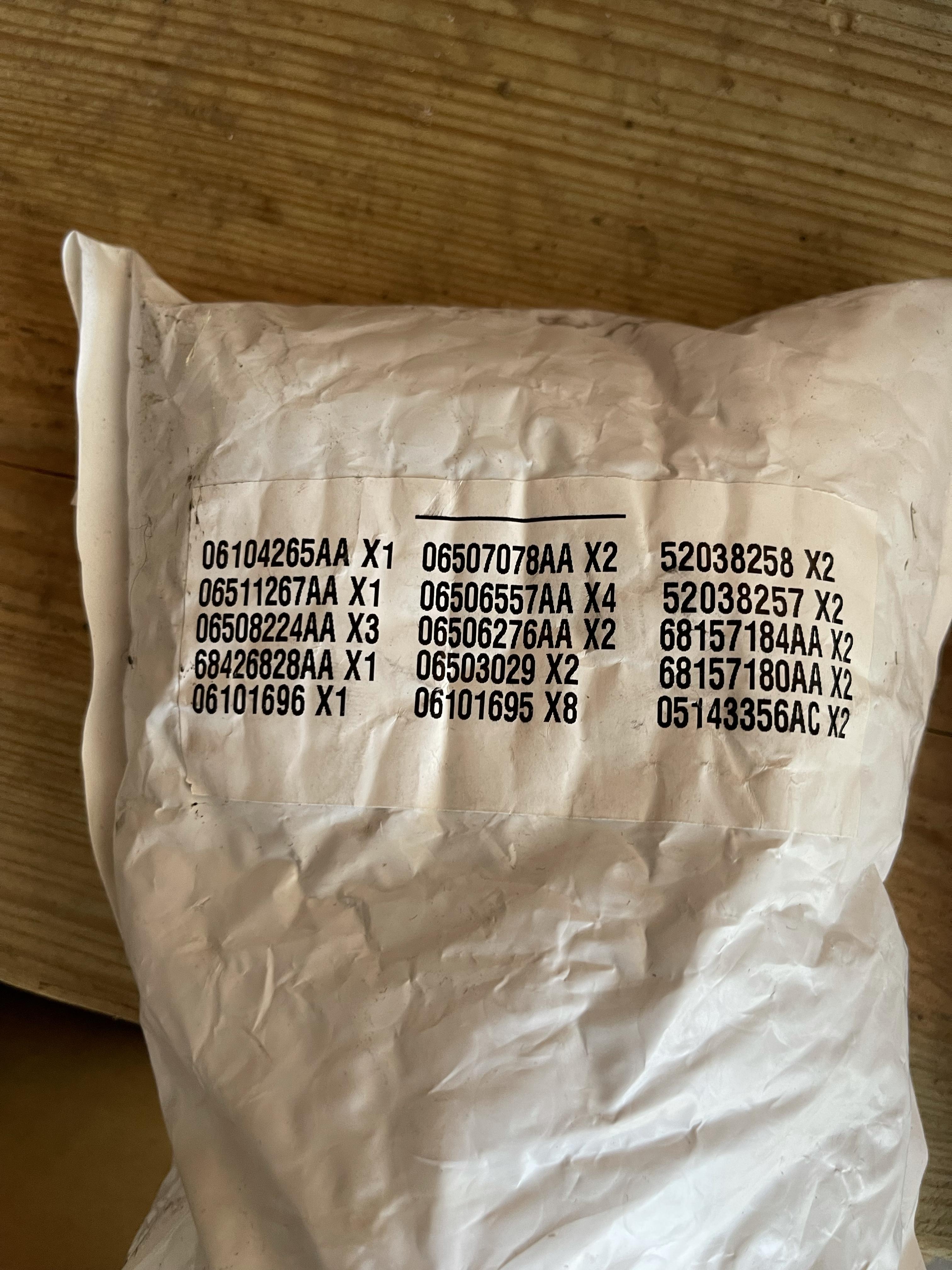

I think I just scored a deal of a lifetime. Got this kit from a guy locally on fb marketplace for $270 brand new. All the shocks were factory sealed in the box but he opened them up for me.

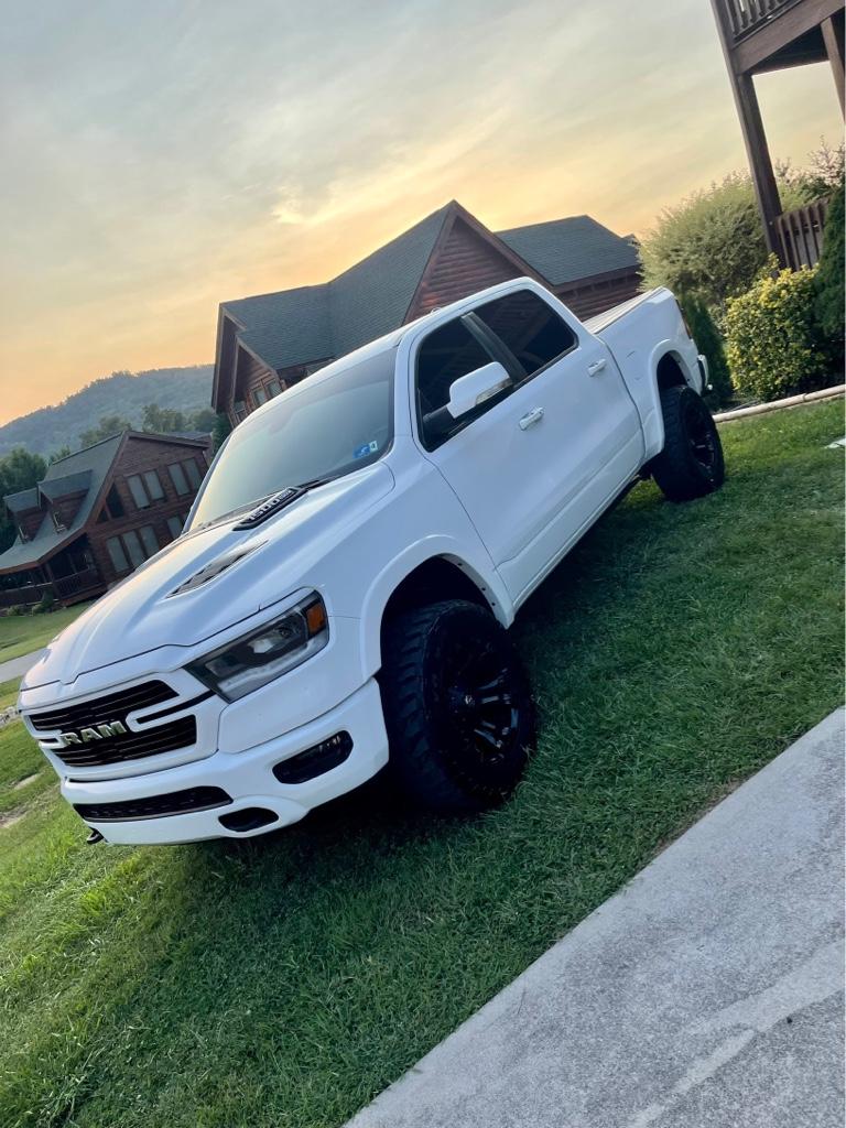

So now Im up for putting tires on the truck after putting the Mopar lift on. I've been all over the map for tire sizes, but was figuring to go for the gusto and either put a 295/60 or 295/65 with the Mopar lift. I am using the stock night edition wheels with the +19 offset.
So if I am following the OP's picture, he fit a 35"x12.50" tire with this lift? I'm looking at the Toyos in the above sizes and they are quoted at 11.8" wide for both the 60 and 65. So if I'm following it correct, only variable is the diameter of the tire since the width looks to be the same between the 2:

FYI anyone running the mopar 2” lift and orp front springs you will likely eventually have issues with the ball joints on the mopar uca’s. I take my truck off road fairly often and my ball joint gave out after 6 months. I almost regret spending the extra money on the “high quality” mopar kit now, even though it did ride very nice when it was in good shape.
