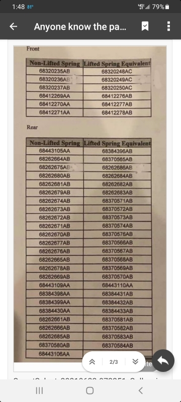

Switch to orp front spring and that will gain you 1 inch. This thread is so old, and so long I never have really figured out if there's an actual updated kit, or a spacer kit, or a spacer in the new kits. But regardless mine had 2 inches of rake as well, so I just did the orp front springs. Now I have 1 inch of rake.Ok after further research. I have no idea the kit I have. I was looking at the spring model number which is 68320236AB. This is the same spring model as the OP but I imagine the springs havent changed. Is there any way to tell by the spring or any other number which kit I have. I did not order it, it came with the truck installed by the dealer. I do know that I have approximately 2" of rake that I would like to lessen. Seems like most who have the updated kit only have 1.5 or 1" of rake.

Is there a Part number for the ORP Front springs? Also can I just use a 1" top mount spacer and new UCA?Switch to orp front spring and that will gain you 1 inch. This thread is so old, and so long I never have really figured out if there's an actual updated kit, or a spacer kit, or a spacer in the new kits. But regardless mine had 2 inches of rake as well, so I just did the orp front springs. Now I have 1 inch of rake.

So look at the tag and part number of the springs on your truck now. Match that to this chart on the left, then to the right of that is the part number for a lifted spring you'll need. Top mount spacer might work. I just wanted to keep everything as much Mopar as I could so there's less chance of a warranty fit. But I just didn't feel the Mopar lift kit uca's were made for more than 2 inches, so I did go different with those.Is there a Part number for the ORP Front springs? Also can I just use a 1" top mount spacer and new UCA?
I didn't. I didn't do rear either.Here’s a question to those who have done this lift with the ORP springs: did you replace the front sway bar links to accommodate for the lift? I was only thinking of the rear and got a new pair of the Hellwig adjustable links, but didn’t think about the front. Thanks for your help!
What year is this chart for? cuz the # I have is not on here. I have 2019 Laramie with OPG and my part # is 68320249AB Just trying to make I have the right spring on the truck.So look at the tag and part number of the springs on your truck now. Match that to this chart on the left, then to the right of that is the part number for a lifted spring you'll need. Top mount spacer might work. I just wanted to keep everything as much Mopar as I could so there's less chance of a warranty fit. But I just didn't feel the Mopar lift kit uca's were made for more than 2 inches, so I did go different with those.![]()
