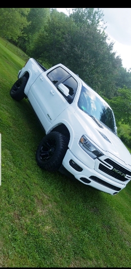

I've only rubbed once but have not had a chance to look underneath to see if I could find where but it was a slight rub. It was on the driver side and I was in reverse, full lock to the right, when my driver side wheel dropped off a curb and I heard the slight rub. Other than that, no issues. I don't go off-roading so have not had any real true tests. I do have 1.5 rear and 1.25 spacers on order (backorder) but we will see how that goes. I'm hoping the spacers don't cause additional rubbing. I'm trying to bring the tires out just slightly (maybe 1/4 to 1/2 inch) beyond the fender more fore a wider stance look. :)
