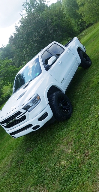

Finally got my tires installed and cleaned up so thought I'd snap a pic. Nitto Ridge Grappler 285/55/r22 shined up with HydroSilex Slick Tire Shine.
Thank you. How's the road noise? I've read that grapplers are noisy.
