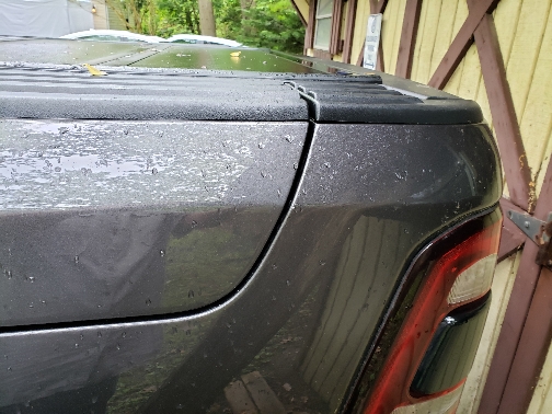

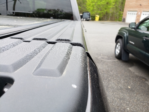

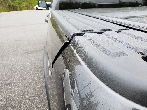

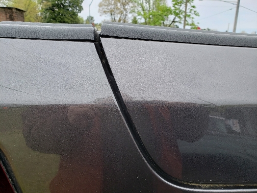

Here are the "before" shots. I'll send the afters tomorrow. I am not sure where to get part numbers. Perhaps the body shop will send me a copy of the paperwork. All I did was sigh a paper when I dropped it off, and another when I picked it up.
Yeah one of mine looks at least that bad so I’m definitely interested in this fix

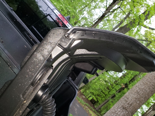

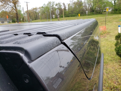

Here are the "after" shots. I don't see any part numbers anywhere. Any particular shot you want to see?

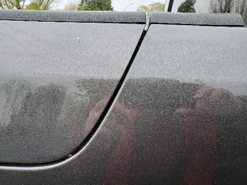

Curious where the steel clamps and screws are located? Mine look identical to your pics on my 2020 Ram, which also has warped lids.
Under the plastic maybe? I did take the truck back the day after I got it because the top corner was sticking out again. The technical came out with a screwdriver and wrench. He took about five minutes to get the corner back in. He said " This is a lot easier since they got rid of the tape and use clamps and screws now."

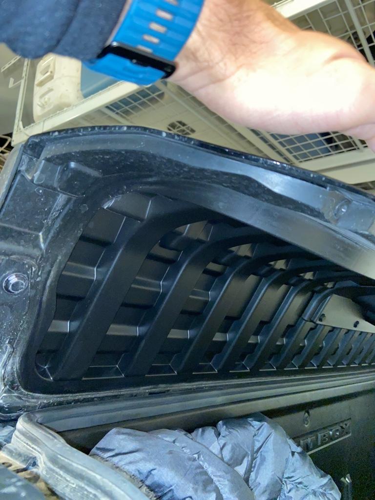

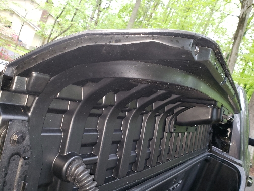

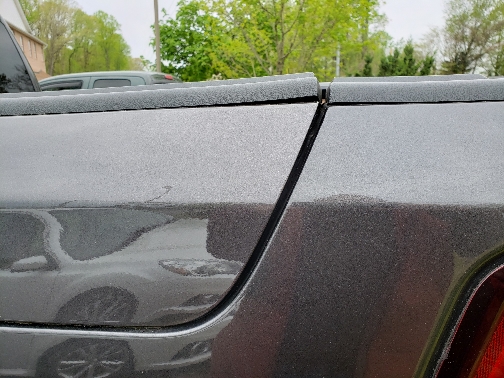

Dealership replaced the top section which is the hard plastic and frame of lid. They re-used the original painted section and clipped it onto the new upper part. It is (was) better, but it is warping as well. This is a before replacement and after replacement picture. Like I mentioned. The replacement is starting to warp now, but has not reached the level of first picture
Thanks for the update. I'm sorry to hear they're starting to warp again, but if they just replaced with the same parts, the same thing is going to happen to the new parts. It's already been mentioned many times in this thread...bad design and no apparent concern to fix it the right way.
