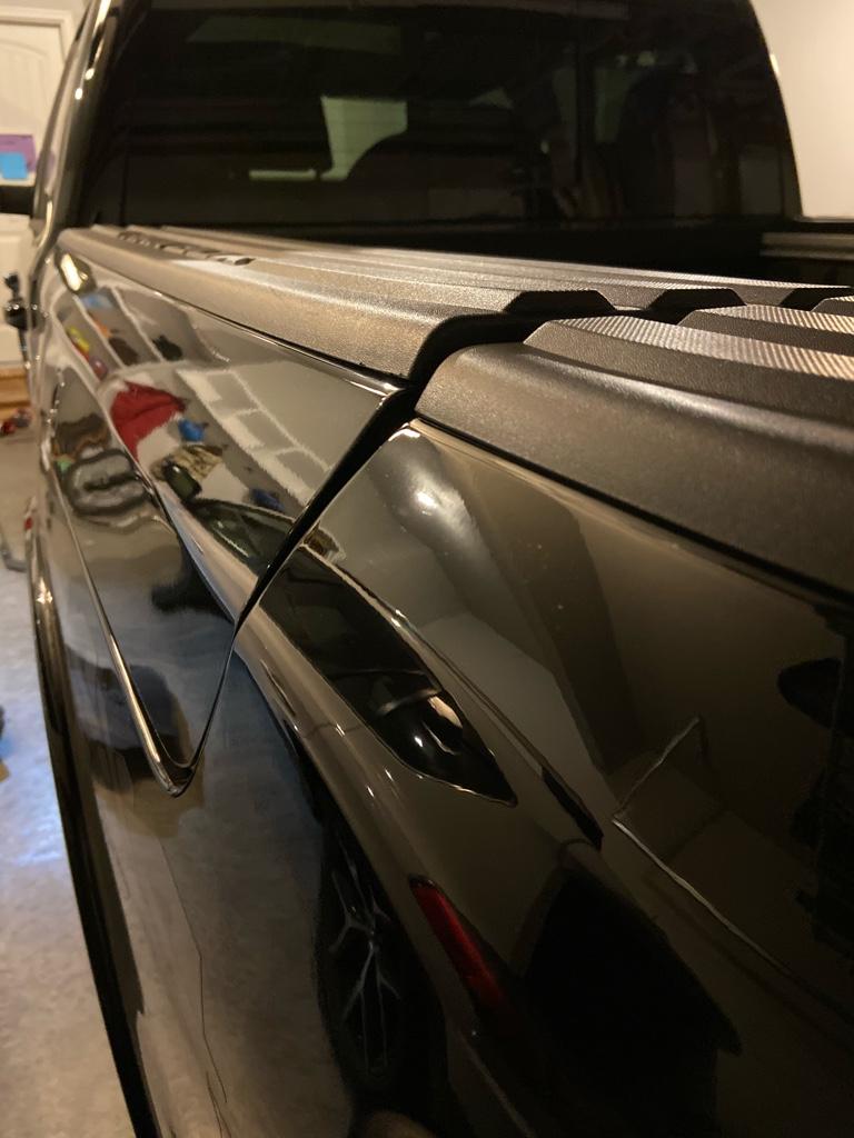

Bought my 2020 new on the lot with warpage, so it doesn’t seem to be due to time, nor have they fixed the issue in 2020. I’m not so sensitive to this concern, as it seemed most trucks on the lot showed the issue and both sides still seal against water ingress. The rambox feature for me was critical in my purchase decision and I decided I can live with this fault for the added function.
That's a great picture, and shows what I think causes the warping. The plastic piece on top warps, which pulls up and causes the painted section (which is also plastic) to warp as well. You can see there is a larger gap between the end of the plastic top and the painted section. And from this angle you can see it curves up from end to end. Compare this to a 4th gen and you'll see there is a huge difference. 4th gens also used a single latch point, so I'm not convinced that's the root cause for this on 5th gens. I don't know why the top piece warps, but I suspect they changed the composition of the plastic for the 5th gen redesign. If you can prevent the top piece from warping you'll cure the problem IMO.
I heard the 4th gen lids were metal instead of plastic
MIne pretty much looks just like the picture. The cap is warped more than the lid. Wonder if it's only the cap that's warped and if removed, the lid would return to normal?? Not that I would EVER try it, but I wonder if the use of heat could remove the warping??
I have the same thoughts you do, I noticed it and determined the benefits outweighed the warping issue.

Beautiful! That looks really great. Hope that holds up for you, you should be really happy with that fitment.
Well had mine replaced last week finally and they look perfect now all around. How long will it last? Who knows. Now that they know exactly how to fix it though, shouldn't be as much trouble next time.
