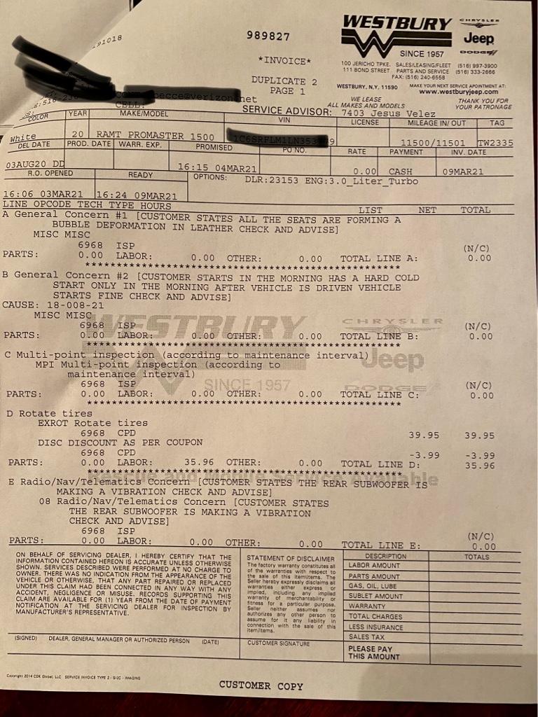

Truck is in for “Hard Start, Remote Start hit and miss, and loud fan running after driving”
Let’s see what’s happens.
Should be getting mine back later today. Service advisor said they did a couple of “Flashes”
Ok... So did I get the update?? Who can read this thing???
Under "Cause" for section B it says 18-008-21, which is the TSB number for the update, so hopefully that means they did it.
The thread title is 18-008-20 -- this guys TSB ends in 21 on his receipt... interested to hear/see what ELSE is included in the TSB ending in 21 vs. the one in this thread.
If you look at Post #8 in this thread it shows a screen shot of TSB 18-008-20 Rev A. I’m not sure if 18-008-21 is a new TSB or if Ram just renamed 18-008-20 Rev A. I could not find 18-008-21 in the NHTSA data base.
