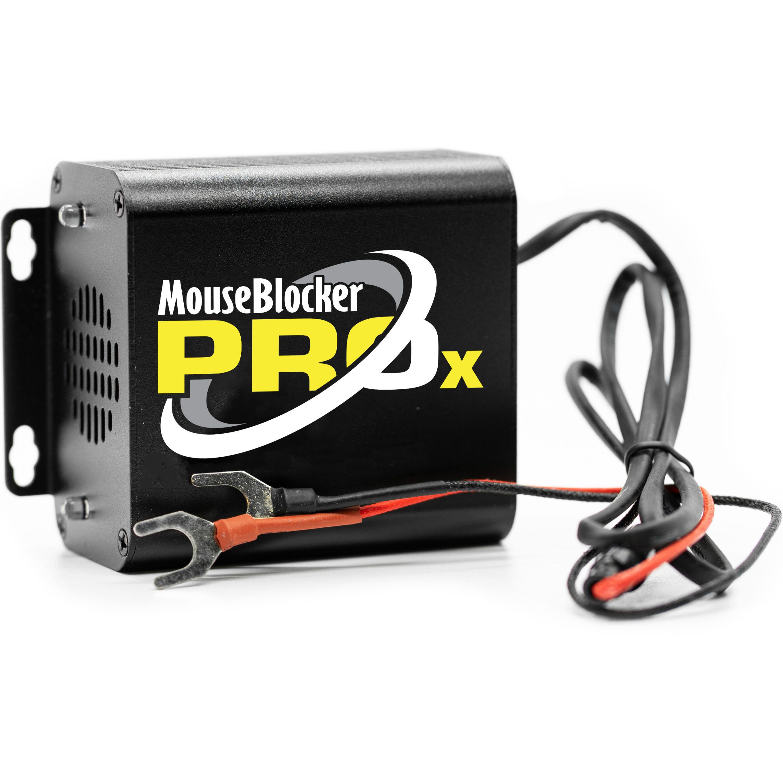

I had this issue with my 2020 Big Horn (25K miles) this week. I just replaced the original battery last week and realized my gauge cluster was cycling on and off every few minutes and also the 12” radio screen at times. I went through everything… looked at the RF hub after discovering I had the window leak issue due to a cracked sliding backlite frame. Unplugged it and still had the issue. Started pulling fuses for the gauge cluster and shifter module and noticed the USB port LEDs were cycling on and off. I was starting to think the Body Control Module was bad when I decided to take another at the wiring in the engine compartment (rodent had chewed through an injector wire a couple months ago). Found more rodent damage to main harness under the master cylinder and also damage to the wiring for the factory bed light kit I had installed. Damn rodents! 🤬🤬🤬
The upside is that I discovered the rear window leak that didn’t know about before it caused any damage.
Has anyone tried one of these?
