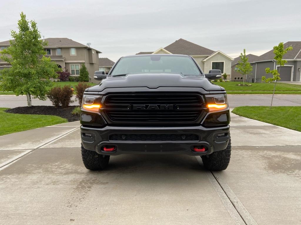

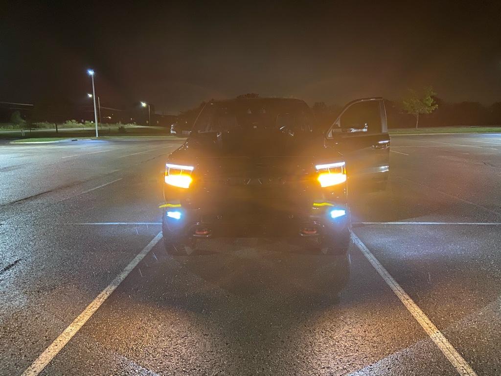

Is there any way to turn on ONLY the turn signals as DRL? I’ve set the turns as DRL, but my white factory LED DRL remain on as well. I can’t seem to find a setting that uses only the turns.
Also, can anyone explain what “Disable Halos” does? I’m not even sure if I have these on my 2020 Laramie...
EDIT for anyone one else as stupid as me :)
The marker lights option on the lights knob starts the white lights as well as DRL, so you need to be on the AUTO setting during the day to get the turn signals only to activate as DRL. No wonder I couldn’t get it at night!
Did you ever get it figured out would like to know setting to it like the second picture just turn signals as drl
You can disable the halos. They re called "signature" lighting, and not DRLs. Then use one of the many options to enable amber DRL.
Ok perfect that’s with the Tazer correct
