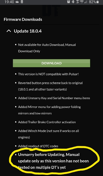

See firmware version 18.0.4 has been released for the Tazer DT. Has anyone installed it yet? Thoughts? Thanks!
@RamTrucks good question! I’d be interested to see if anyone has downloaded this yet, I don’t wanna be the first, lol. Does anyone know what updates it includes?
2019 Ram 1500 Big Horn CC | Black Appearance Package | 3.92 Anti-Spin | DS InTune w/ Jay Greene Custom Tune | B2 Fab. Magnaflow w/ Resonator Delete | S&B CAI | Hellwig Swaybar | 2” Rear Lowering Springs | Tazer
You do not.
Just had a chance to read their website and it looks like they say you should....
Sent from my SM-N976V using Tapatalk
