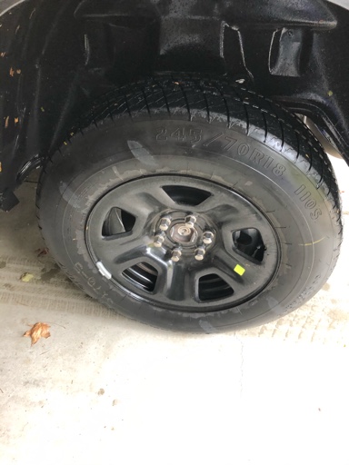

What you listed were my concerns as well, especially in regards to being off-road somewhere remote that you might not want to run a temp spare. I went ahead and replaced my 18" steel spare with a stock wheel (Painted/Polished Aluminum 20") paired with a matching BFG KO2 275/60R20 tire. I was concerned that the center hole wouldn't fit the spare tire lift plate, which was an issue on the 4th gen Ram 1500s, but the spare tire lift does manage to fit even though the center hole is quite a bit smaller in diameter than the spare.
I went ahead and took some pictures in case anyone is interested.
Appreciate this! Even fit a 33" BFG under there! Did you modify or bend the shroud at all?
I actually asked the service adviser that usually helps me for service and recalls about fitting a 5th identical full size spare and was told it would not fit.
I looked myself at the house and measured a around 1 1/2" to "spare" inside that aluminum shroud cover, but the spare appeared so tiny and pathetic I wasn't even sure if i could get the stock 275/55/r20 without removing shroud.
Will pass the info on to the adviser next service.
I didn't modify any of the heat shield around the tire, it managed to fit up there without any issues. In regards to your service adviser, I want to say that there was an issue on the 4th gens about fitting a full size spare. For sure I think there was an issue fitting a stock wheel on the 4th gen spare lift cable. Perhaps that's what your adviser is familiar with still.
Either way, glad the pictures helped someone else out so they know what fits under there.
An aftermarket wheel would typically have a larger hub opening requiring a spacer in use.
It looks like the 33" 275/60-20 is a tight fit as a spare. I thought it has been posted a 34" would fit. Does it look like there is adequate room?
P.S. From the pictures, it looks like the spare is useless if off-road or towing. If you are somewhere a KO2 is needed, the OE spare isn't the answer.
