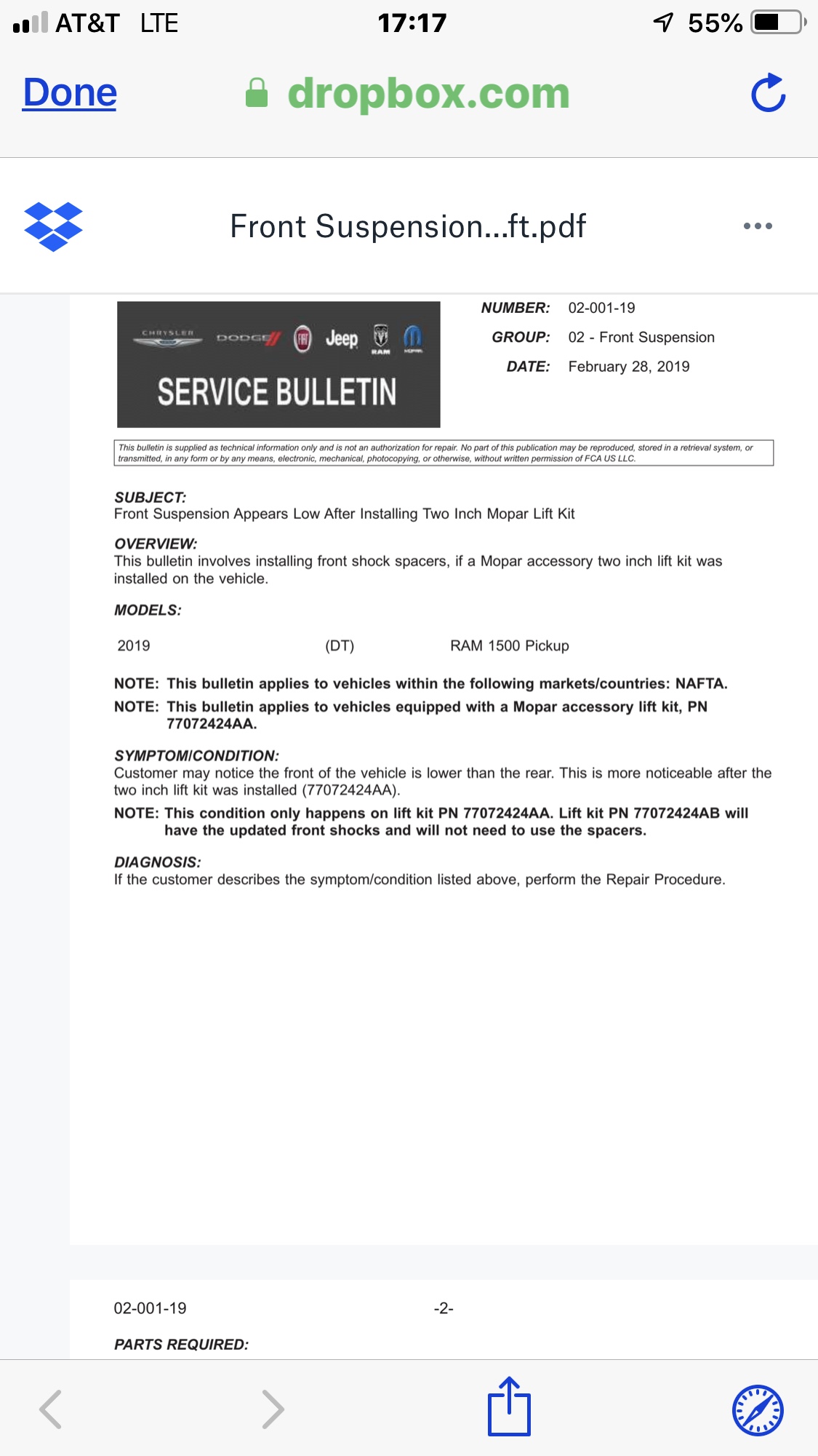

I just did the search to and can’t find it either. I’m not sure now. I would go to the dealership that’s closest and ask for the part numbers. Also there is a TSB for the Mopar lift. I’ll try and find it
I have the Mopar lift on my Big Horn. I have had warranty work approved for the shock spacer mentioned above - so the parts/labor are covered at no cost to me. I have also ordered a set of ORP springs ($120/pair), and there will be no labor charge for spring replacement. My parts are about 10 days out.
I read on another post that the spacer mentioned above provides .5” to .75” of lift. The ORP springs should provide another 1”. Hopefully someone else will report how much front end lift the spacers provide before my parts are installed. If it’s 2”, I will skip the springs. I have to say that I am doubting the 2” theory based on my measurements and the fact that the Mopar lift is supposed to be just that - a 2” lift front to back, and not a level, and based on the fact that these trucks come stock with a 1.5”-1.75” rake. My truck measurements are currently as stated below. I measured in various places, because it’s hard for me to determine what area of the truck needs to look level.
