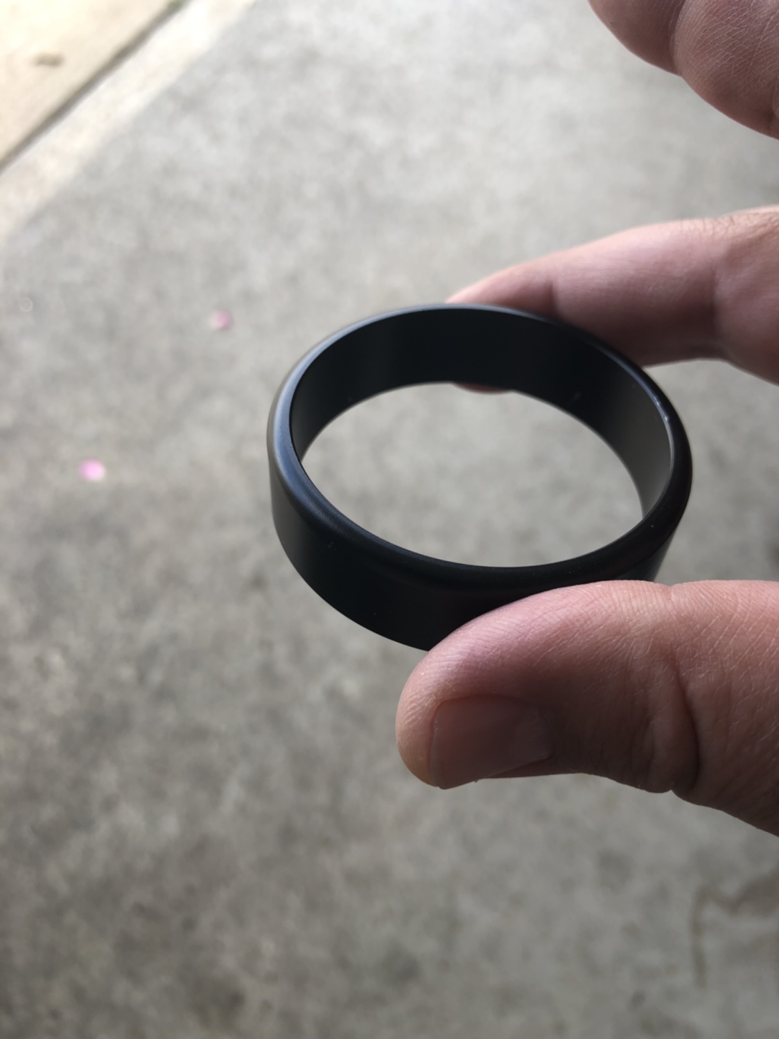

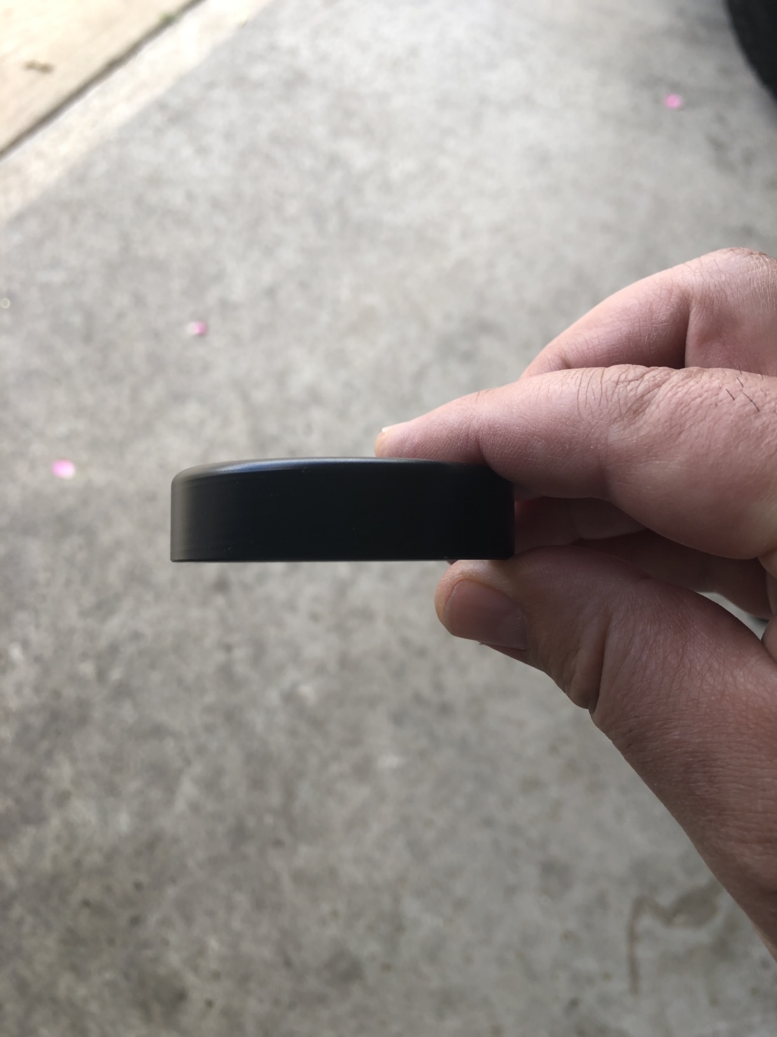

I have a Mopar 2”Lift. Don’t like the rake. Got this part number from another member (68465804AA) Spacer, Front shock. Didn’t come up on the Mopar site. Called and they do have it but need to special order it. Was told it will provide an additional 2” to the Mopars 2” Lift. Was about $60 a piece. I know there were a few others here looking to reduce their rake. Hopefully this helps.

^^^^. This is what’s going to be done with my truck as soon as the parts arrive. I wasn’t aware that it lifts the front an additional 2” though.

Yeah that's quite a bit. Can you guys take some measurements before and after so we can verify how much? I'd like to do this but might be limited on how much due to parking garage height.
Also... Almost looks like there are two spacers on the pic Jake posted. If that's the case, could maybe do just one.

I believe it only adds an additional 1" in the front. The 2nd ring you are seeing in the original ring that came with the older lifts (# 77072424)

I got the spacer PN68465604AA to add to the front of the Mopar lift. It’s definitely not as big as the parts guy said. It’s just over 1/2”. Im getting them put on tomorrow along with the ORP Springs. Hopefully the rake will be less noticeable.
