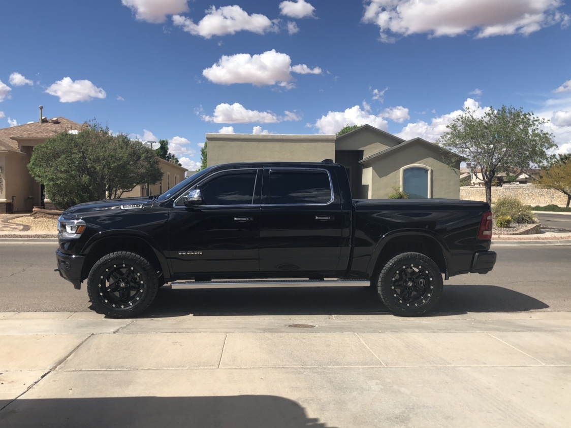

Tried to put it on as level of a surface. For me this is exactly what I want. I thought about 35” tires but went with 305/55/20. Just over 33”.
Yummy, that thing is sick. Next set of tires though go with the 35x12.50, they will fit :devilish:
Looks good skol. I wonder how much each part added. My parts are ordered so I guess it's a matter of time before I find out.
The added spacer for the Mopar Lift was just over 1/2”. The ORP springs vs the Non-ORP was about an inch longer. So about 1 1/2” give or take
Looks great. I will be skipping the.5” spacer. I run the same sized tires but on 18” wheels (275/70R18). I have the Big Horn without the fender flares, and I don’t want the lift to make the wheels look undersized. I will post pics when mine is done - hopefully by the end of next week. Thanks again. This is great.
