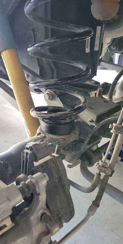

Well took about 4hrs with some breaks and of course the other side is always faster. I'm at Firestone getting a alignment, we'll see how off it is in a few! Snapchat-2102057324.jpg Snapchat-1020469481.jpg Snapchat-2007594560.jpg 20210302_153621.jpg

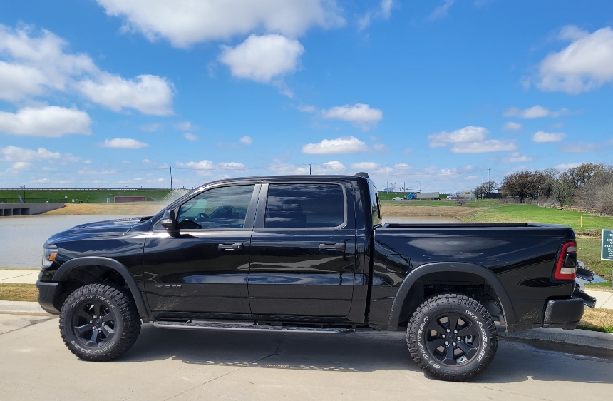

So how does the front compare to the rear? Looks like you got 2 inches instead of 1.5.

Isn't a Rebel only an inch taller than stock?. I would think you'd get closer to 2.5" of lift. I hope I get 3.5 on my non-ORP truck.

I had to add a 1 inch motofab lift in the rear to gain a little rake back. As for the ride it's not as smooth as the stock suspension. I only noticed it because I commute the same route to work everyday and can feel dips a little stiffer. I have 5100 on order and the RC will do for now!

Perfect stance imo. Are you going bigger for tires?

It was still enough I had to lift the rear an inch to get a little rake back. In some of pictures it looked nose high.
